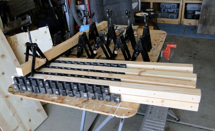

September 10, 201115 yr comment_40779 Â A friends grandfather passed away and they were cleaning out his small woodshop. They saved me these "wood clamps" Â When I picked them up, I have never seen any like them. Can anyone till me what and how? There are 10 Â 2X2s with the black plastic half rounds in them. There are 4Â scissor clamps with screw and handle There are 4 scissor clamps without screw and handle. Â I have NO idea. I place one clamp where it looks like it may go. Â Report
September 10, 201115 yr comment_40786 Double bar clamps for edge gluing panels. One 2X on top and one on the bottom. The metal thingie fits over both at each end and hooks into the plastic notches. Tightening the screws clamps the edges together and clamps the boards on the top and bottom to aid in alignment....less planing and sanding. Here's a site that may explain it better. Double Bar Clamps Report

September 10, 201115 yr comment_40781 I use these type of clamps all the time for cutting board and panel glue ups. They are also called "4-way Clamps" as they clamp with pressure on all 4 sides. One key to make sure that the glue won't stick to the 2x4 basses is to use clear packing tape to wrap the face and sides of the 2x4's as the glue won't stick to the tape. I keep wanting to pick up a few more of these clamps as they work great. Yes, they are a bit awkward to use at first, but once you get the swing of it they are easy to use and you will wonder how you lived without them.  You can also find them "HERE" at Woodcraft. Report
