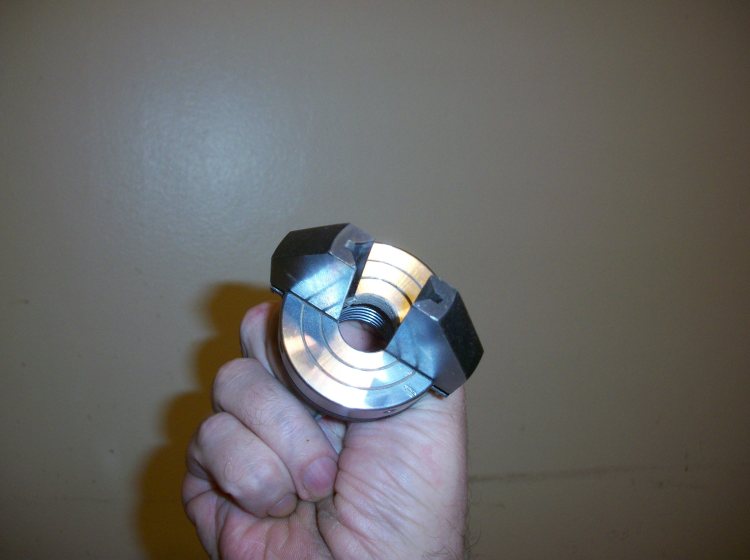

September 13, 201115 yr comment_40693 Â This concerns the blank drilling chuck, Item CSCPENCHK from PSI . While opening it to fit in a blank to be drilled, one of the "wings" for lack of a better word, fell off, now after trying for about 15 minutes to get the thing back on, it isn't straight.It looks straight, yet when I go to drill a hole, I notice that it is slightly out of alignment but not by much, but what is there is enough to nearly vibrate the lathe off the stand.Anyone know how I get this chuck straight again? does anyone else here even use one? Â As it is now, all penmaking is at a stop until i can figure out how to align this thing corectly. I have emailed their support but as yet have not got a reply, of course its only been a half hour anyway. Â Â Charles Report

September 13, 201115 yr comment_40697 Charles, it sounds like when the jaw came it you got some backlash introduced into the system. Here's what I'd try. Remove the screw from the jaw (wing) that fell off. re-insert the screw and gently push the jaw away from the center of the while you slowly turn the screw counter-clockwise. You'll feel the leading edge of the screw drop a bit as you turn. When it drops, turn the screw clockwise until the threads engage. This will bemove the backlash from the jaw. If you still have wobble, do this procedure to the oher jaw.  Ron DudelstonAbove and Beyond WoodWorks Report

September 14, 201115 yr comment_40695 they're called snap ring or split ring pliers. they have different size pins to fit differing sizes of holes so be sure to buy the correct size if you need to. Report
September 15, 201115 yr comment_40694 I'm glad you posted those other pictures. It really helps to understand what your problem was. I think when you get those pliers it you should be able to get them back together. John MoodyJohn Moody Woodworkshttp://www.johnmoodywoodworks.com Report
