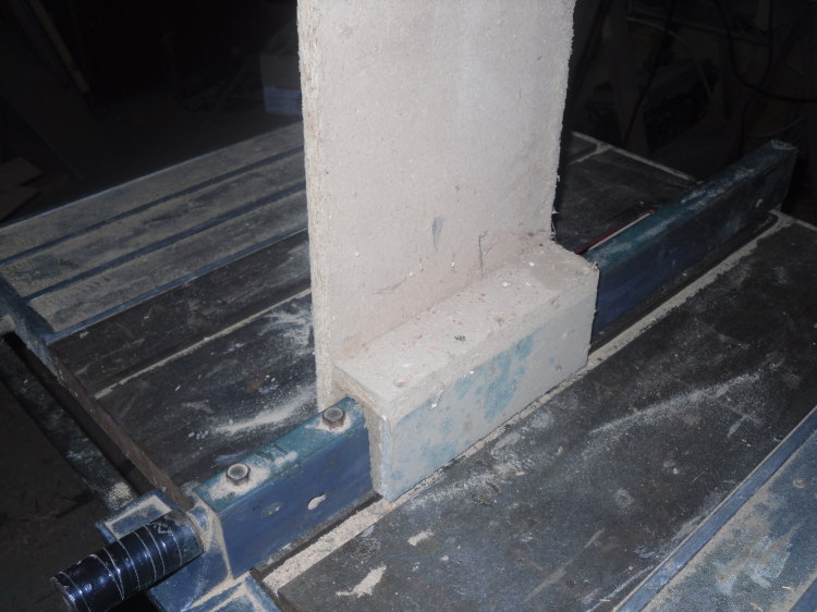

October 3, 201115 yr comment_40105  A fence slider for raised panels...Just three pieces of "particle" board, and some screws.  Sized to fit over my fence.  This is a "back side" view.  It also is sized to fit over the bolt heads. Front view.  The panel would be just clamped to the upright part, the sawblade would be tilted to the angle needed.  On this saw, the blade tilts away from the fence.  Not much to it...  'and may the road raise up to meet ye' Report

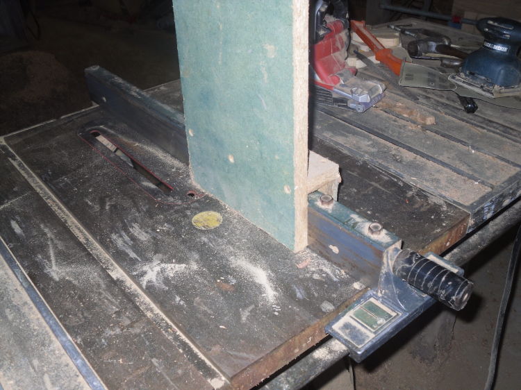

October 3, 201115 yr Author comment_40106   Panel is held in place with just a couple clamps.    'and may the road raise up to meet ye' Report
