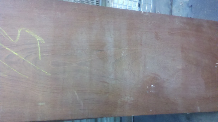

October 6, 201115 yr comment_39964 I am working on a small kitchen island 2' x 3'. They purchased a very nice piece of Brazilian Cherry to use as the counter top. The board they brought me is 15" x 84". The top will need to be 27' x 39". So here is the question for you, would you just edge join the two pieces and trim off the excess to get the 27" wide, or would you rip into smaller boards and glue it back up keeping the orientation of the board as they were before cutting? I'll post a picture of the board later tonight.   John MoodyJohn Moody Woodworkshttp://www.johnmoodywoodworks.com Report

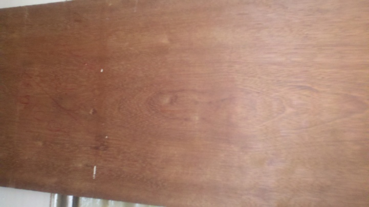

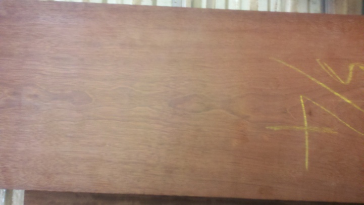

October 7, 201115 yr Author comment_39967 Sorry I had hope to have these up last night but just didn't work out. The pictures are not great but it is what I have. Â Thanks for all of the suggestions. Â They were taken with the board standing up so the top picture is the top of the board and so on. Â I'll be working on this over the weekend so I appreciate you suggestions. Â Â John MoodyJohn Moody Woodworkshttp://www.johnmoodywoodworks.com Report
October 7, 201115 yr comment_39966 John2.. Here's what I would do. Remember 15" x 84". Joint one edge and cut the piece to 7 1/2" x 84." (Don't worry about the width of the saw blade. Center the cuts.)Cut the two 7 1/2" x 84" into 7 1/2" x 42".Remember, each of the four boards can be repositioned 8 different ways.  Pieces can be flipped over and end-for-end. Arrange the boards for the best look. Always look for grain patterns that blend into the next board.Now, if you really want satisfied customers, call them over after you have prepared the four boards and get their opinions before doing the final milling and glue-up. BTW, two boards at a time. Better control of flatness.Larry Report
