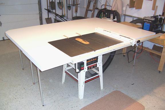

October 10, 201115 yr comment_39836 What's a "Saw Horse?" Guess I'm pretty fortunate to have the room, and the saw capability. When I used to use them, I always positioned the plywood to just "hang over" one of the horses.. Larry  Report

October 11, 201115 yr Author comment_39833 Good Morning Fellows,WOW Larry, what a set up and I noticed your planer on it's own rolling table/horse. Nothing like tools that you can move around the shop for ease of use and return them to their home spot when not in use.It is important when cutting plywood in the manner described you want the face of the sheet down to avoid feathering or marring the face. Report
