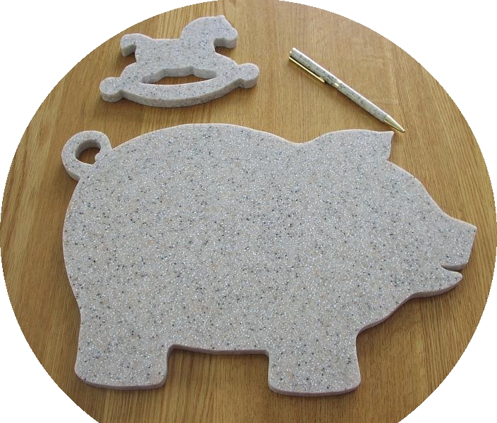

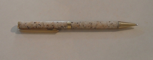

October 18, 201115 yr comment_39408 I'm not sure this idea has been posted on this site, so thought I would throw it out there.  I bought a chunk of Corian and made different products from it.  Here is one of them.  The Corian was 1/2 inch thick, which I cut into a strip and drilled the hole down the center for the cartridge.  Corian 1/2 inch thick will only make a slimline, but I understand you can get Corian that is thicker.   A small piece of corian could make a lot of pens.  The hardware for this pen was very inexpensive. Corian is not pleasant to work with as it makes lots of dust.  Anyone turning this product will definitely want to wear a dust mask.  You don't want to be breathing this stuff into your lungs.   I thought it would be clever to hook up with a Corian dealer or someone that installs Corian countertops, etc and make a bunch of pens for them to give away as a promotional item to prospective buyers.   SQ     It it can't be fixed with glue and sawdust - it's not worth fixing. Report

October 20, 201115 yr comment_39418 Back to the use of Corian. I have glued some of the 1/2 " pieces together with CA glue and then turned them to a larger pen size and it is awful difficult to see the seam line at all. Give it a try. Report
October 20, 201115 yr Author comment_39417 That's a very good idea.  I have glued up Corian before and yes you really can't see the seam. Just haven't done it for a pen. SQLeo Pedersen said:Back to the use of Corian. I have glued some of the 1/2 " pieces together with CA glue and then turned them to a larger pen size and it is awful difficult to see the seam line at all. Give it a try. Report
October 20, 201115 yr Author comment_39416 Thanks for the information.  SQArlin Eastman said:SueIf you have a section of Corian you can cut 2 pieces 3/4" thick and glue them together to make a larger pen, works like a charm. Also Penn State Ind has a Micro Miter Chop Saw that cuts up to 1" thick material. I hear it works really well on all pen material.Here is the link    http://www.pennstateind.com/store/MTS4.html  and any extra blades (Carbide tooth) only cost $9.95Arlin Report
October 20, 201115 yr comment_39415 Hey Charles,When I glue up Corian, I always glue shinny side to shinny side. I use the thin Ca to glue up Corian, the only thing is that it will bond it instantly, so be sure that you are ready to put them together fast, then I clamp them just to be sure that they are togetheer real tight. When I glue up the red and white, I always turn the pieces on edge and make a mark where I want them to come together at, I also put a piece of wax paper under them so that the thin glue will run out on the wax paper. Report
