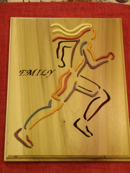

January 15, 201214 yr comment_39181 Arlin, I made this by combining the "fret" method and the bevel cutting method. "Fret method" means that for every cutout area, I pre-drilled a tiny hole, as small as possible so the blade just barely fits thru it... the holes are drilled at an angle, which is found by testing for the bevel angle I wanted. In this case, I wanted to make sure the cutouts could be pressed in from the bottom so they protruded, yet didn't come all the way through... thus, the cutouts had to be wider at the bottom than the top... and when pressed in, there was no gap between the parts. Test cuts to find your bevel angle requires using a scrap of the stock you'll be using and the same blade you'll be using... and it has to be a flat, not a spiral blade... I suggest size #3 or smaller. This method uses solid wood, not plywood. I use wood 1/2" to 3/4" thick.  I start my tests at a table angle of 2 degrees and I cut any small shape... I note where I begin and end (which is the same as noting whether I need to cut clockwise or counterclockwise... those terms confuse me because when you move the workpiece counterclockwise, the cutting is occuring clockwise.) I push the piece through to see if it is what I want... I adjust the angle until I have what I want. It is often somewhere between 2 1/2 and 4 1/2 degrees. Now I know what angle to drill the holes at, but I do tests to get familiar with drilling in line with my intended cutting. After cutting out all the pieces (which I number on the backside) I can sand and shape the protruding parts, then color them... and glue them back in when dry. (I don't actually glue them in the usual sense... I press them in dry, then add glue on the back side... I don't want to risk glue squeeze out.  The simple solution is to do the other method you asked about... ie. just cut out the parts and add a black or colored background to show through the cutout areas... it isn't easy to create a multi-colored background to simulate what I did w/colored parts. This method is best with thinner wood that is either plywood or solid wood. (For this method, I use plywood 1/8" to 1/4" thick and the colored background can be stained wood or felt or foam or even paper glued onto the backside. ) Another method is simply cut out the parts and shape and color them and glue them (freehand) onto your solid boxtop. Spence  Arlin Eastman said: Thanks Greg I have a question, how do scrollsawers make a cutout and then add some color to it? Can I do a complete cut through and add a backer to it for a different background? How can I put colored woods into it to fit really well. I do not have a bunch of time to make the lids of the boxes, however, I want them to be the best they can be to the couples they go too. Arlin Report
January 17, 201214 yr comment_39180 Spence, thanks for sharing this project with us. It is amazing what you did with it. Thanks also for the tutorial. We've been trying to build up the scroll saw forum here and have been needing members who will take a really active role, so I look forward to your participation.Spence Bloom said: Arlin, I made this by combining the "fret" method and the bevel cutting method. "Fret method" means that for every cutout area, I pre-drilled a tiny hole, as small as possible so the blade just barely fits thru it... the holes are drilled at an angle, which is found by testing for the bevel angle I wanted. In this case, I wanted to make sure the cutouts could be pressed in from the bottom so they protruded, yet didn't come all the way through... thus, the cutouts had to be wider at the bottom than the top... and when pressed in, there was no gap between the parts. Test cuts to find your bevel angle requires using a scrap of the stock you'll be using and the same blade you'll be using... and it has to be a flat, not a spiral blade... I suggest size #3 or smaller. This method uses solid wood, not plywood. I use wood 1/2" to 3/4" thick.  I start my tests at a table angle of 2 degrees and I cut any small shape... I note where I begin and end (which is the same as noting whether I need to cut clockwise or counterclockwise... those terms confuse me because when you move the workpiece counterclockwise, the cutting is occuring clockwise.) I push the piece through to see if it is what I want... I adjust the angle until I have what I want. It is often somewhere between 2 1/2 and 4 1/2 degrees. Now I know what angle to drill the holes at, but I do tests to get familiar with drilling in line with my intended cutting. After cutting out all the pieces (which I number on the backside) I can sand and shape the protruding parts, then color them... and glue them back in when dry. (I don't actually glue them in the usual sense... I press them in dry, then add glue on the back side... I don't want to risk glue squeeze out.  The simple solution is to do the other method you asked about... ie. just cut out the parts and add a black or colored background to show through the cutout areas... it isn't easy to create a multi-colored background to simulate what I did w/colored parts. This method is best with thinner wood that is either plywood or solid wood. (For this method, I use plywood 1/8" to 1/4" thick and the colored background can be stained wood or felt or foam or even paper glued onto the backside. ) Another method is simply cut out the parts and shape and color them and glue them (freehand) onto your solid boxtop. Spence  Arlin Eastman said: Report
