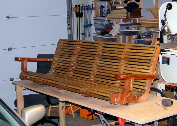

October 25, 201115 yr comment_39059 Many years ago, my father-in-law gave me some Cherry. It wasn't good wood, but I was able to salvage enough of it to make a swing. The original Amish plans called for an 8' swing made with 1' Oak. It would have weighed a ton and would  have needed log chains to hold it up. I redesigned it, re-sized and reinforced it. The only problem was that I used regular wood glue on the lap joints. That was not to be a problem, it was on a sheltered porch. At our new location, it is in the open. The joints started to fail and soon it looked unsafe. Rather than pitch it, I rebuilt it using Red wood and WWIII water proof glue. It has 150 SS screws in the slats and the finish is UV protected. However I doubt that the finish will hold up to the intense sun here at 6000+ ft elevation. This project took more than a week of steady work, but was worth it. Report

October 25, 201115 yr comment_39065 Great looking swing Ron. That should be nice to put where you can watch some nice sunsets. What is WWIII glue? Titebond III. John MoodyJohn Moody Woodworkshttp://www.johnmoodywoodworks.com Report
October 25, 201115 yr Author comment_39064 My age is showing, WW II is my saw blade Your are correct Titebond III  I can't place it where it faces west, but where it is I can see part of the sunset reflected color on the clouds and we get an occasional double rainbow in our view. Report

October 25, 201115 yr Author comment_39062 Larry, you wouldn't want the plans if I still had them. I bought them at an Amish lumber company, based on the picture on the front. Poor choice, The basic design was OK, but chain balance points were wrong and it was large enough to accommodate a whole family. When I first sat in it it nearly tipped over. After I corrected that, I found that the angle of the back, in relation to the seat, was wrong and bothered your back if you sat there very long. I did some we research and hopefully corrected that. My finished product does resemble the picture, but that is about as far as it goes.  Report
