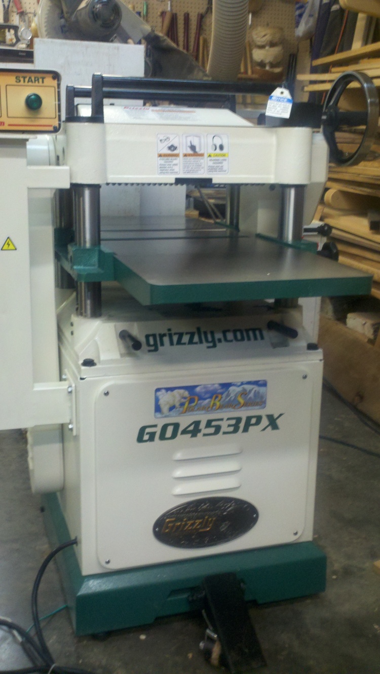

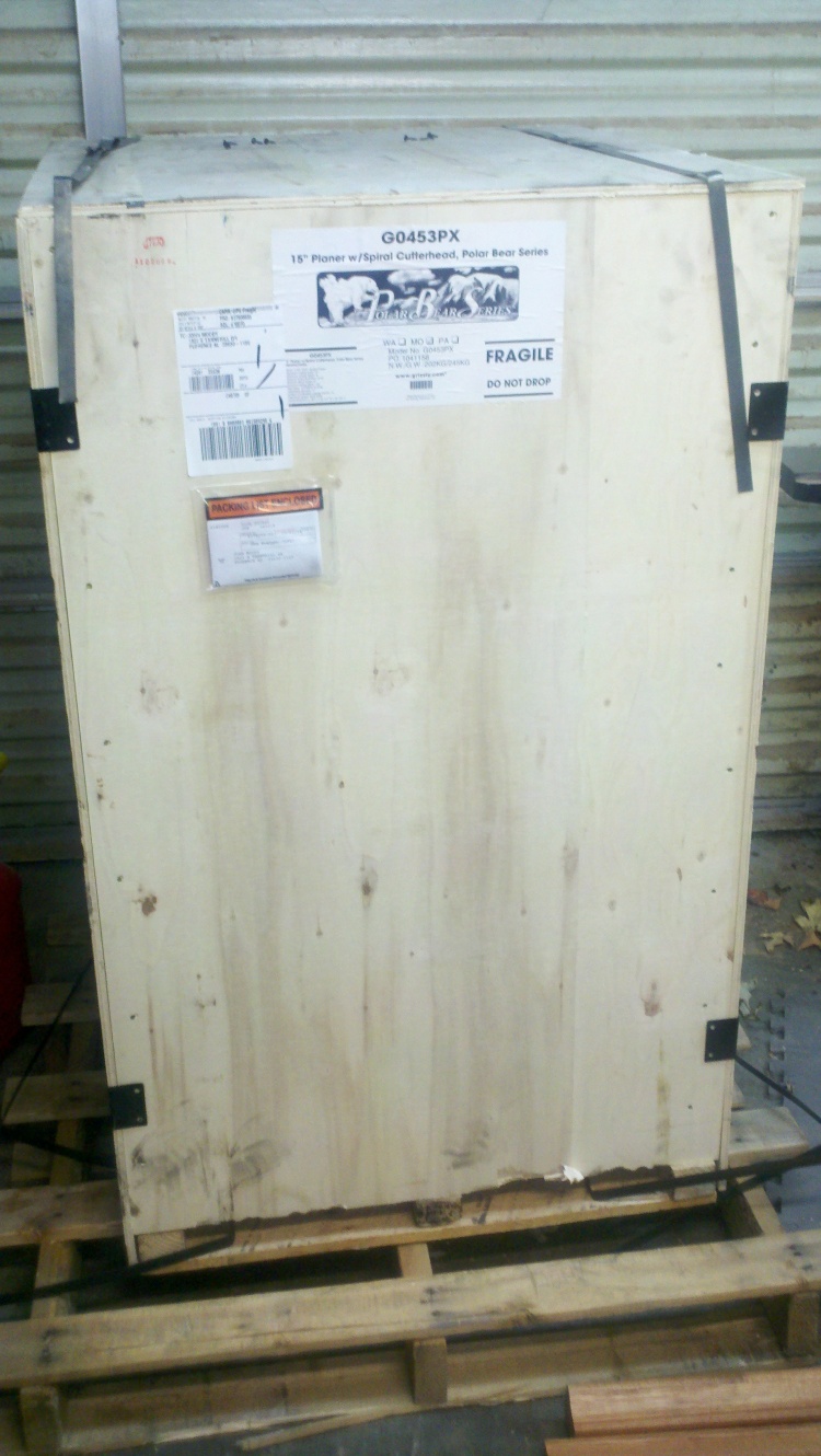

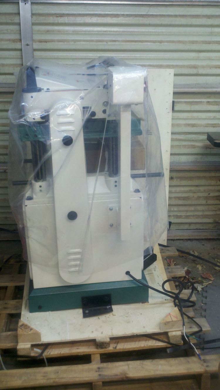

October 28, 201115 yr comment_38922 Yesterday I added a new member to the shop crew. I know it will fit in well and be welcomed by all of the other tools in the shop. Â It came shipped in a very nice container. Â Â I was thankful I paid the extra on the shipping for the lift gate service since it weighed in at 665 lbs. I was also very thankful that I have a good UPS driver that let it down, put his pallet jack under it and rolled it all the way into the shop. I was really dreading having to try to slide it around. Â After a little work with the hammer and chisel, the case popped open and it was given it's first view of the new surroundings. Â After it was released from the pallet my son and I got a little work out getting it off the pallet. Did I already say it was 665 lbs? We got it on the floor and I got the panel open and found the instructions in a box inside the cabinet. It listed the tools you needed to put it together and the first thing on the list was a fork lift. Â Well I only wish the shop was big enough to get a fork lift in there to set it down. Â Thankfully it come with most everything assembled. I had to attach the extension wings, the hand wheel, the dust collection hood and install the front caster so it could be rolled around. Â Only found a couple of problems. One of the stabilizer feet was missing from under the front. I will be calling them this morning to get another. The instruction say to check the gear box oil before you run it, but the location of the place to check it is from another machine and not this one. And I didn't know that it didn't already have a plug on it so I didn't have a 220 plug in the shop last night to put on the cord so I couldn't fire it up. I'll have to weight till tonight to see how it runs. Â A few things are going to have to get rearranged to make room, but for now it is playing nicely with the other. Â I did get the one with the Spiral cutterhead and I am looking forward to seeing how it preforms on some maple. I took Bob Klose's advise and waited to purchase the one with that head. Â I hope to give you an update after the weekend on how well it preforms and how the others in the shop like their new helper. Â Â Â John MoodyJohn Moody Woodworkshttp://www.johnmoodywoodworks.com Report

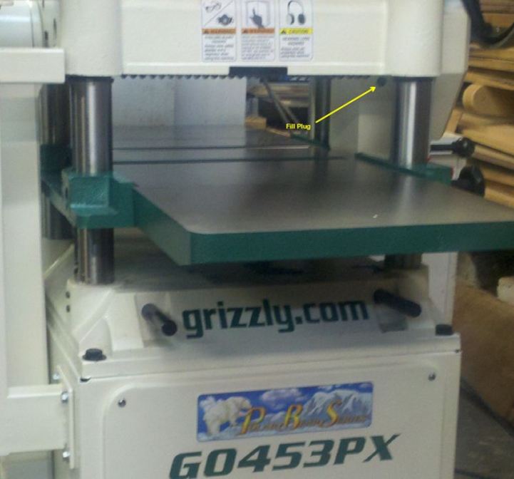

October 31, 201115 yr Author comment_38924 Well I got the planer all setup finally Saturday night after getting back in town. I had to get 220 power over to it and put an end of the power cord. Â Here is the interesting thing I ran into on this planer. There is a warning sign on the top handle of planer saying "Notice - Check gear box oil before operating." There are notices in the beginning of the manual that say to be sure to check the gear box oil before operating the planer. On page 11 it describes how to check the gear box oil. You remove the gear box fill plug, put the small end of an allen wrench in and if it is covered with oil all is good. Here is the real kicker. On page 31 it has a warning about checking the gear box oil before operating the planer. Then on a stop sign at the bottom of the page, it states in the stop sign that the unit is shipped dry, No gear box oil in the unit. Wow, why not just say "Put Gear Box Oil in Before Operating the Unit - Unit shipped without Gear Box Oil." Â So anyway, I stopped by the auto parts store and picked up some 80-90w gear box oil. Â Now to remove the gear box oil fill plug and pour it in right? Â Notice where the fill plug is located. No way you are going to pour oil in unless you lay it on it's side. Remember it weights 665 lbs. So back to the store to pick up some 3/8" tubing to insert in the fill hole and pour oil into the gear box. Â Well after all of that, I got to final turn the unit on. On my, how quite this thing is. It isn't much louder than turning on my 3 hp Unisaw. So I couldn't wait to run a board through, so I had a 20" or so piece of rough poplar laying there and put it up on the table and slid it into the planer, It took hold of the board and ran it through. It will really remove the wood and it quite in doing so. I could actually hear my dust collector running on the other side of the shop over the noise of the planer. One turn on the wheel raises the table 1/16". Couple of passes and the board was clean as a whistle. With the carbide cutter head it looked like it had been sanded to about 400 grit already. Â The only other thing I will have to get used to and I am not real sure I am totally happy about is the table raises and lowers instead of the cutter head. It is not a problem unless you are doing a long piece that needs extra support. I got the infeed and outfeed extensions level and had no snipe on the board I ran through. I am happy with it even with a few challenges in getting it all going. I'll add a bit more after I spend some real time with it this week. Â John Moody John Moody Woodworkshttp://www.johnmoodywoodworks.com Report
