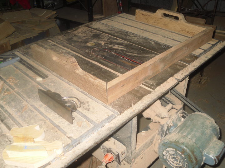

October 28, 201115 yr comment_38892 My "assembly" table, Das Frankensaw.   Nice and flat, with easy to use reference lines to square things up with.  'and may the road raise up to meet ye' Report
October 28, 201115 yr comment_38891 Donr that too Steve! If fact if it is a smaller project and I hant to make sure it is "dead" flat, tI'll use the table saw.steven newman said: My "assembly" table, Das Frankensaw.   Nice and flat, with easy to use reference lines to square things up with.  'and may the road raise up to meet ye'  Ron DudelstonAbove and Beyond WoodWorks Report

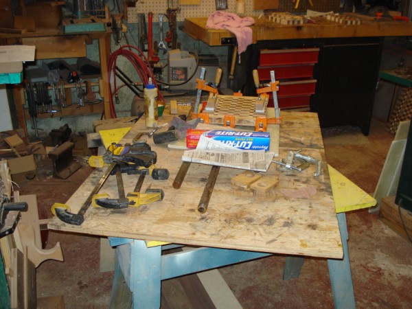

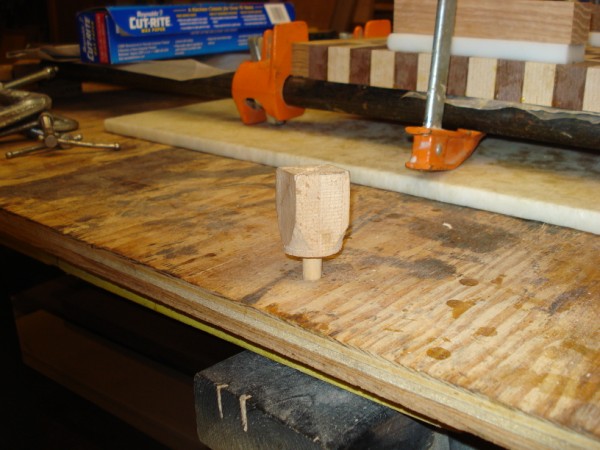

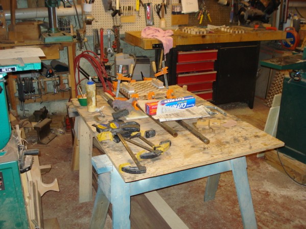

October 28, 201115 yr comment_38890  My work bench started off pretty level but has warped over the years. Since I have not had the time to build a new one, I get by with what I got. I use a 36"x36"x3/4" sheet of white melamine with one side for glue ups as glue does not stick to it and the other side for assembly as it is flat. I have used my table saw top on occasion but I don't like going that route unless I have to as I don't want to get glue and such on it. Allen WorshamCorona, CAallenworsham@earthlink.nethttp://www.awcreationsandwoodcrafts.com'Graze in every man's field, but always give your own milk' J. Vernon McGee Report
October 28, 201115 yr comment_38889 Waxed paper is best.Arlin Eastman said:I was just thinking of the tablesaw I used also to put the box together. I layed down paper to keep metal tools from nicking it up or liquids from spilling on it. So now my thought is maybe I should not use my tablesaw to assymble with.Maybe I should build a small torsion box?Arlin  Ron DudelstonAbove and Beyond WoodWorks Report

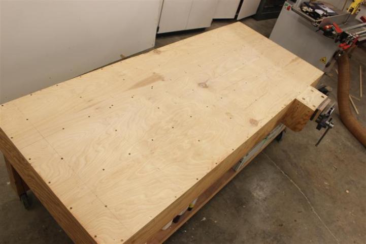

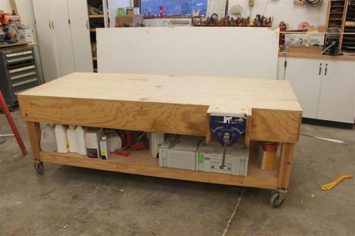

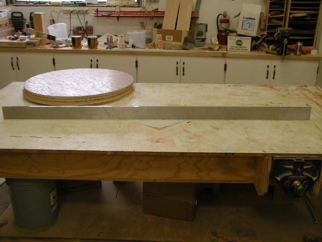

October 29, 201115 yr comment_38884 I learned long ago a good flat surface can't be beat for both accuracy and ease of assembling "stuff". Â So, I made a rolling flat multipurpose work table. If you could see the inside of the plywood box directly under the melamine you'd see the grid work of a torsion box. With my 6 foot starrett machinist straight edge I can barley slide a sheet of paper under it. The melamine is replaceable as needed. Report

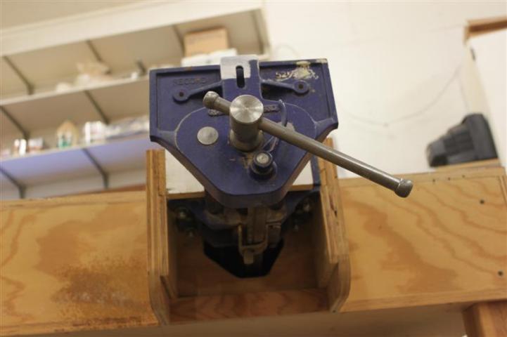

October 29, 201115 yr comment_38880 Arlin, The torsion box part of the bench is 36'' wide and 90'' long. This allows 6'' over hang on each and 3'' on the ends so I can clamp "stuff" to the surface. I used a grid pattern of 12''. The depth is 9 -1/2'' which is probably over kill but this was my first torsion box of sorts. If I were to do another one I'll thin it down some. The leg were let in the bottom on the box and extend all the way to the bottom of the of the of the top piece of plywood. To put the vice in the table I cut a hole in the side and one of the inter grid members. I mount a 3'' thick block of oak lever with the top piece of plywood and supported with the plywood brackets on the side. I hope this is clearer than mud. I've been using this bench for 13 or so years and it has stayed sold as a rock including the vice mount.  Rich   Report
October 29, 201115 yr comment_38879 I did my after assembly. That's why the hole under the vice is so big. That hole was cut big enough I could get my hand inside and cut the holes on the inter grid member. Arlin Eastman said:RichDid you mount the vise before you put the top on?Arlin Report
October 29, 201115 yr comment_38878 Not being familiar with you vice I can't answer that question. The biggest reason I did mine after was I got my vice at a later date. I would think that as long as you keep everything flat and don't have do any thru cuts of the grid members you probably could. Manny times I build as I go without any real plan. Arlin Eastman said:RichSo could I add the vise before I put the top on and save all of the trouble?ThanksArlin Report
