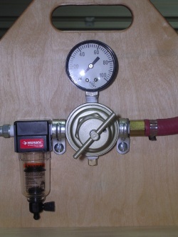

After joining the International Association of Penturners I have been highly impressed with the home brewed synthetic pen blanks that these artists are casting and turning. There is almost no limit to the types of materials that can be cast into pen blanks.
I have been called to the dark-side and have built my casting pressure rig. It consists of on old paint pressure pot on the right and a regulator with an oil / water separator. Once the cast mold is placed in the pot I can pressurize the pot, once I'm satisfied that the pressure is stable I have a shut off on the inlet side to the pot and a direct reading pressure so I can monitor the pressure and make sure I don't have any leaks. It's a pretty simple rig and somewhat straight forward process. Tomorrow I will make some molds. Thanks for viewing!

Years ago, I helped a friend develop a "cold casting" business. We worked primarily in cold cast Porcelain. We had a 2 step process that assured no trapped bubbles remained in the castings. The first step was to put the wet casting in a vacuum chamber for about 1 minute. Then transfer the castings to a pressure chamber- similar to yours- ours had a plexiglass window. The combination of the two processes completely eliminated any bubbles in our castings.
Lew
My press pot will double as a vacuum chamber for stabilizing, I need to find a pump and plug the press gauge on the top to protect it.
