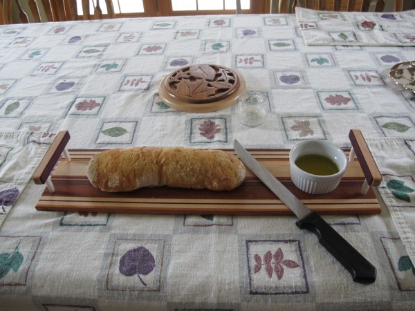

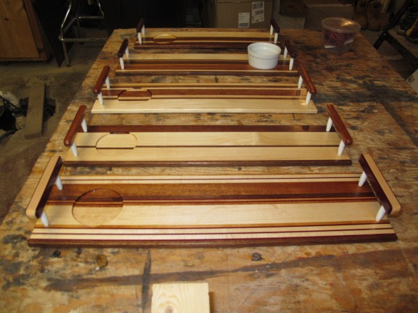

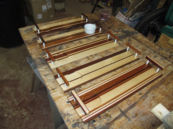

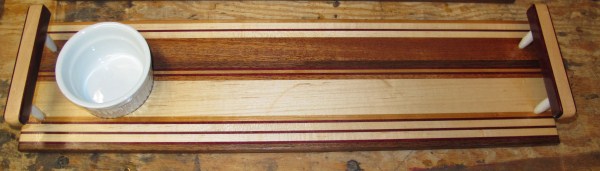

November 8, 201115 yr comment_38152 When a friend showed me her Oil and Bread Boards, we knew these were going to be my next set of Christmas gifts. UPDATE- Home made bread and herded Olive Oil for dipping!!  These are made from Maple, Walnut, Cherry, Sapele and some Purple Heart. They are 16†to 20†long and 5†to 6†wide and about 3/8†thick. The handles sit on white posts from Hobby Lobby- bought all they had and need some more to finish the remaining 8 boards. The posts are actually necklace “beads†and are captured with a 2 1/4â€- 6×32 flat head machine screw. The ramekins are from Pier One Imports. They sit in a 1/8†deep recess. Clear rubber “Bumpers†on the bottom to act as non-slip feet. The finish is pure mineral oil. Mimi said she will make marinara sauce and we will bake baguettes to complete the gifts. As always- comments and criticisms are always welcome. Lew  Report
November 8, 201115 yr comment_38163 Those turned out real nice!I have seen similar ones before but the hole for the bowl was done all the way through so that the bowls would not tip or slide when using a knife or spoon as well as not fall out when carrying. How did you do the 1/8" recess? it doesn't look like a typical forstner bit as there is no center hole. Allen WorshamCorona, CAallenworsham@earthlink.nethttp://www.awcreationsandwoodcrafts.com'Graze in every man's field, but always give your own milk' J. Vernon McGee Report
November 8, 201115 yr Author comment_38162 Thanks for the kind word!I thought about making the hole go completely through but went with the recess instead. To create the recess, I cut a hole in some 3/4" stock, clamped it to the board and used a top bearing pattern bit on my plunge router.Allen Worsham said:Those turned out real nice!I have seen similar ones before but the hole for the bowl was done all the way through so that the bowls would not tip or slide when using a knife or spoon as well as not fall out when carrying. How did you do the 1/8" recess? it doesn't look like a typical forstner bit as there is no center hole. Allen WorshamCorona, CAallenworsham@earthlink.nethttp://www.awcreationsandwoodcrafts.com'Graze in every man's field, but always give your own milk' J. Vernon McGee Report
