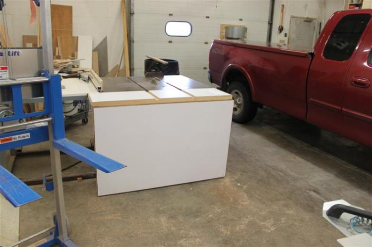

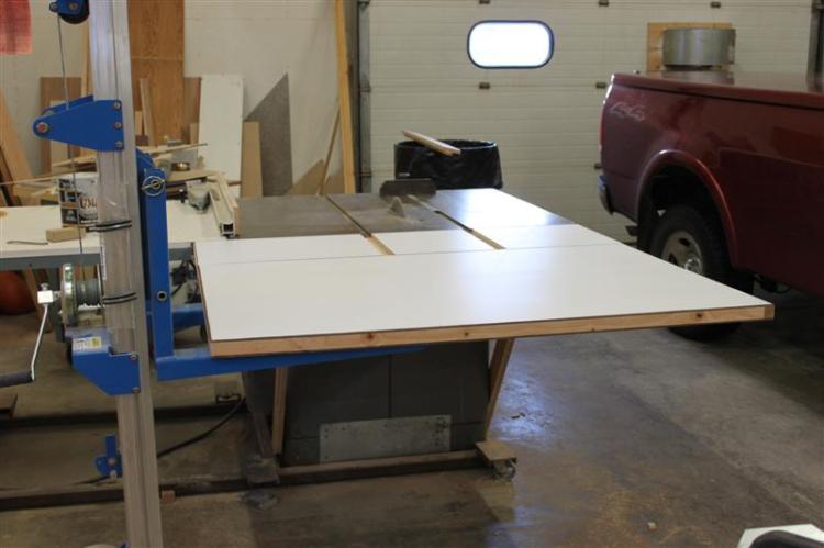

November 8, 201115 yr comment_38109 I've been working on a fold down out-feed table for my table saw. I'm at the stage I need to make/install some fold down/up table legs. Anyone have experience with type of hardware? I can go with either just the hardware and make my own leg or complete folding legs. I would need some adjustment in the leg as one side it 1/2'' shorter that the tallest side. Long side is 34". As a side note we have a nice brisk 0 degrees today. Report

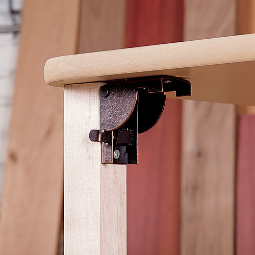

November 8, 201115 yr comment_38113 I have the Rockler folding outfeed table on my Jet contractor saw which works very well. Since you already have the table made and you just need the hinges, you can buy them separately from Rockler for about $11 for the pair. They work very well and support enough weight for the table for cutting and medium weight if you want to use it as an assembly table. I would not trust them for heavier weights. You just add them to your pre-made legs of about 1.5" square or so. The brackets are locking both in the open and closed position so you have to push a button to release them when you unfold or fold them. Here are the leg brackets from Rockler: http://www.rockler.com/product.cfm?page=5817&filter=folding%20l... Â Â As for adjustability, you can drill out a hole in the bottom of the leg and put in a threaded "T-Nut" and then install a threaded leveler or glide which you can get at your local Home Center or Rockler. Â http://www.rockler.com/search_results.cfm?srch=usr&filter=t+nuts&Search.x=0&Search.y=0 Â Allen Worsham Corona, CA allenworsham@earthlink.nethttp://www.awcreationsandwoodcrafts.com 'Graze in every man's field, but always give your own milk' J. Vernon McGee Report

November 9, 201115 yr comment_38111 Rich, I built a fold up extension on my work bench and used these from Rockler. Â They have held up good, they lock in place when down. Â Â John Moody John Moody Woodworkshttp://www.johnmoodywoodworks.com Report
