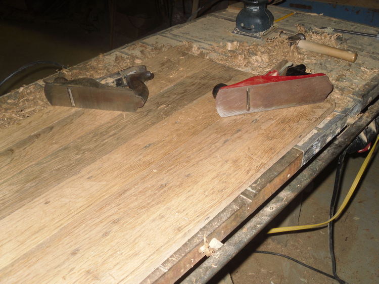

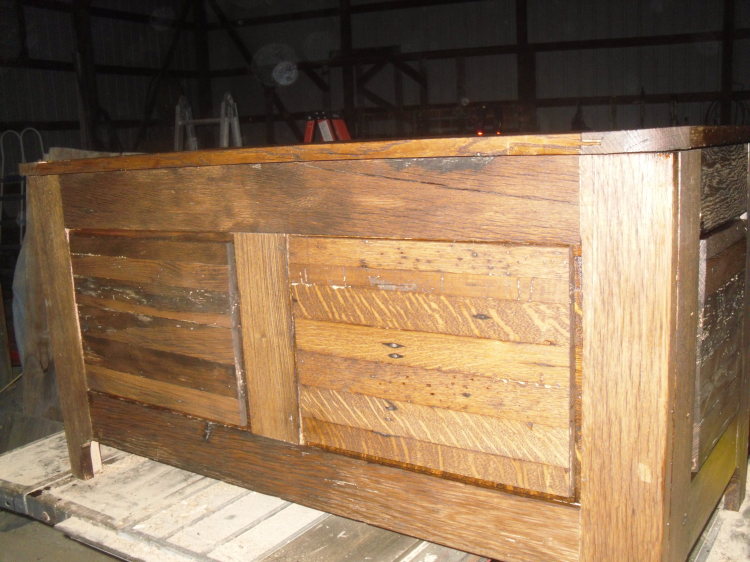

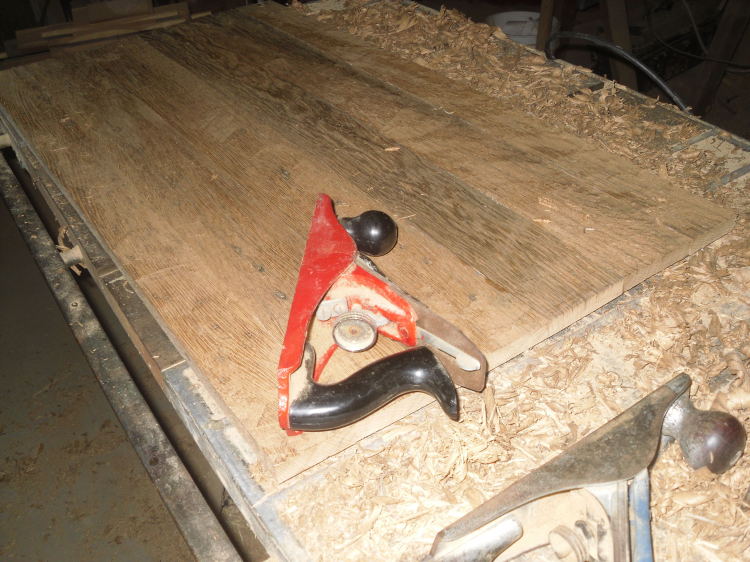

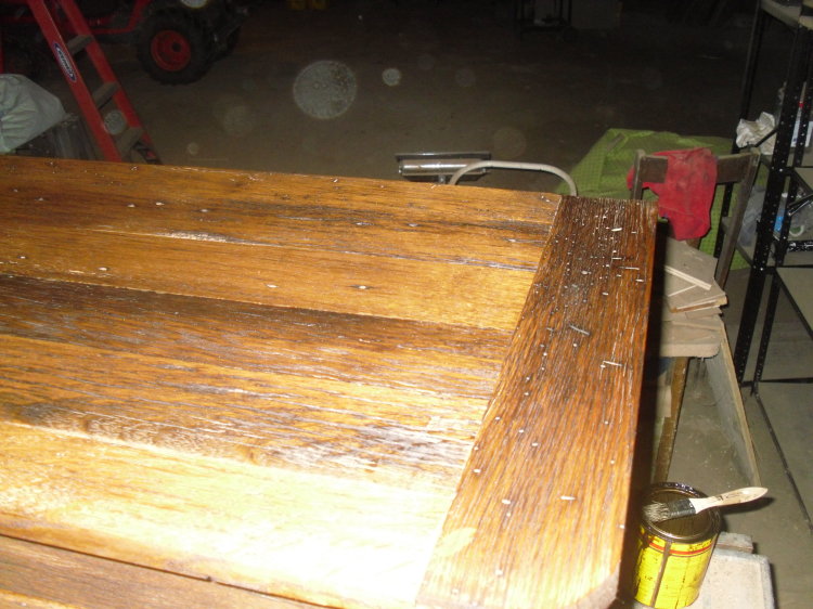

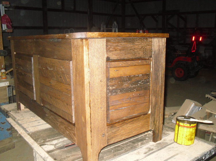

November 9, 201115 yr comment_38075  Got the top completed tonight.  Also the first coat of stain. first a scrubbing down by Great Neck.and a smoothing down by another plane.  setting up to bread board the top.  That is almost all the dado blades I've got, sitting there. Width of cut was 3/4".    I had one more 1/16" chipper I could have put on.  Clamps also helped hold things down. And now a shot of that stain.  First coat, mind you, and yes there are a few spots I missed.  'and may the road raise up to meet ye' Report

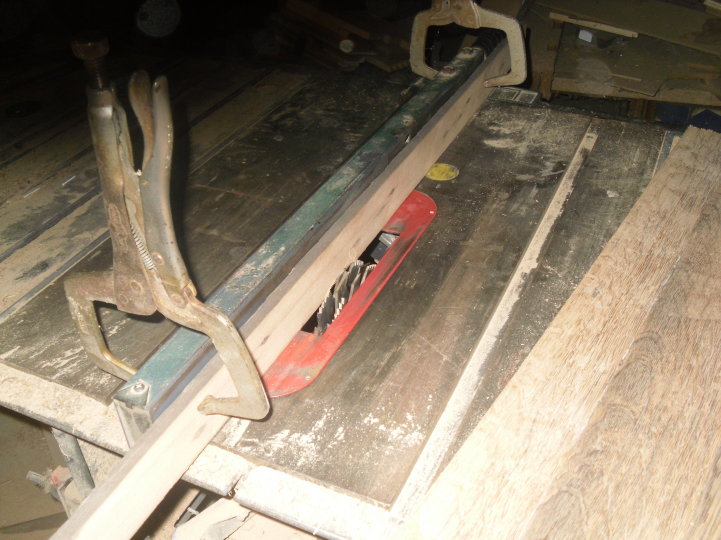

November 9, 201115 yr Author comment_38077  Try again, computer REAL sloooooww this morning.  A few that didn't get posted last night:this is my dado set-up.  I buried a bit of the one blade in the wooden fence.  Yes, I can get as wide as a dado can on this saw, in fact, I still had enough room for one more 1/16" chipper.and a look at the back side. yep, I missed a few spots, get them later.    Still need some hinges, another finish coat of stain, and a few coats of varnish.   Be about 20 hours all together.   I wonder what Norm would say....  'and may the road raise up to meet ye' Report

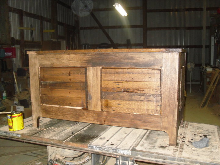

November 13, 201115 yr Author comment_38076 Was out at the shop tonight, and was bringing in the last of that old barn wood.   What IS left at the site is only fit for a woodburner.  While dropping off the boards at the shop, I also started to de-nail them, cut them down to an easier to use length, and get them ready to use.   I also put on a heavy coat of varnish on this little box.    I always put a heavy first coat on, then I go about smoothing things down.   That way, I don't worry about "sand thrus".    Varnish made some of the figure come alive....  'and may the road raise up to meet ye' Report
