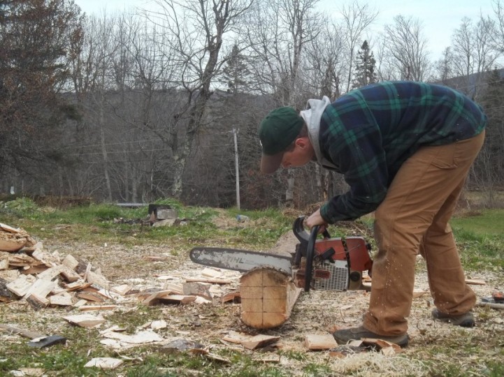

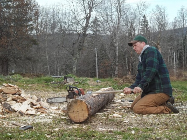

November 13, 201115 yr Author comment_37912 That is quite the broad axe though maybe a bit more than I would want to spend. I might talk to a guy at work though, he builds knives and swords and we can purchase steel at work for scrap iron prices. As you can imagine, US Navy warships have some of the strongest steels in their hull so I got access to some really hardened steel. I am not sure if the blacksmithing would take some of that strength out or not, but I can envision building a nice, tough, sharp broad axe so thanks for the link. I also took some pictures while I was hewing my second beam, one of the 4x8 inch beams. As you can see from the pictures, its not really that hard. I had this one hewn out in an hours time, but planing it square to all four faces took another hour or so. Overall it is time consuming, but the beams do look nice in my home, and that is what counts. Â Report
