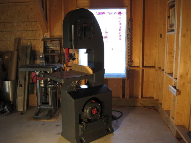

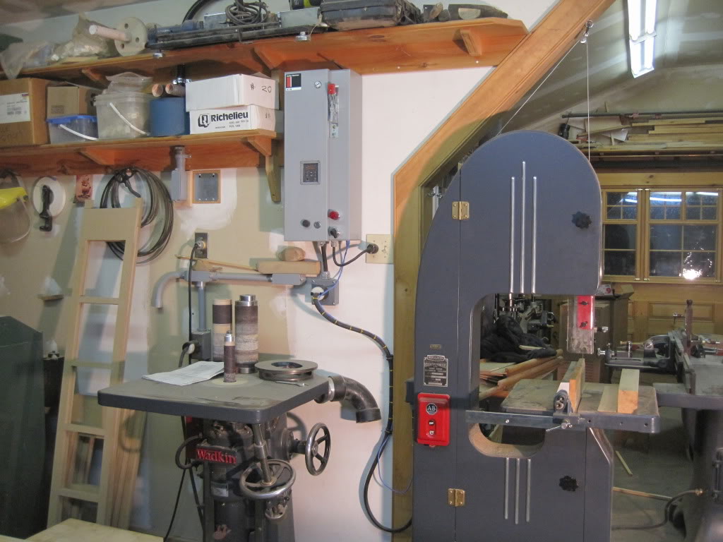

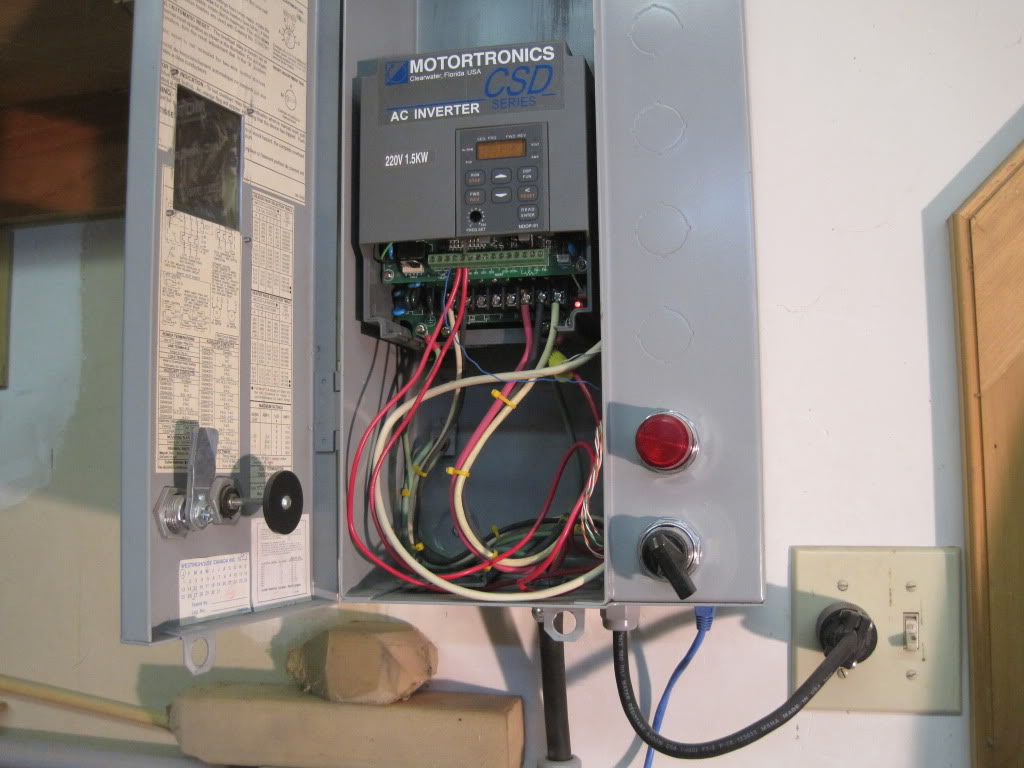

November 17, 201115 yr comment_37743 Lasts year I restored a rare 1942 Bursgreen band saw from England. It was to replace my Aggazini from Italy that was 40 years newer. The problem was I did not have 3 phase in the shop set up and so it sat in the rat hole for a year used. My old boss from 25 years ago was at the shop and i told him i was selling the agazzini and he said he wanted it. Out it when for $1200. This is the saw sam malloff used to make his chairs  and a very nice saw. I found a VFD to run the Bursgreens saws 2 hp 3 phase motor for $50 on the list and so it was time for the move. I put the VFD in a old disconnect box on the wall next to the saw. and added a twist lock plug with a cat5 clable for the switching control. this will let me use it for my shaper too . i cut a little window out of thwe door to see the LED display.  next post please    Report
November 17, 201115 yr Author comment_37754 Lasts year I restored a rare 1942 Bursgreen band saw from England. It was to replace my Aggazini from Italy that was 40 years newer. The problem was I did not have 3 phase in the shop set up and so it sat in the rat hole for a year unused. My old boss from 25 years ago was at the shop and I  told him I was selling the agazzini and he said he wanted it. Out it when for $1200. This is the saw sam malloff used to make his chairs  and a very nice saw. I found a VFD to run the Bursgreens saws 2 hp 3 phase motor for $50 on the list and so it was time for the move. I put the VFD in a old disconnect box on the wall next to the saw. and added a twist lock plug with a cat5 cable for the switching control. this will let me use it for my shaper too . i cut a little window out of the door to see the LED display. I had finished this a year or so ago and for handle i had used off the shelf plastic ones . I have come to believe that handle are like the jewelry of the machines. I like the look of the british rose wood infill planes with brass and steel. so I made all new handles from scratch I also wanted to add a balance for the upper gulides so i soldered up a peace  of copper waste pipe  and filled it with sand. works great and now the  guild are very easy to adjust. I think it looks OK what do you think?  jack English machines   Report
