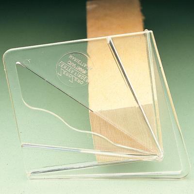

November 19, 201115 yr comment_37717 Cool idea! I use one of these-Â it works for both round and square pieces Report
November 19, 201115 yr Author comment_37716 My husband just bought one of those (ours is yellow) from Woodcraft but I have not tried to use it - yet. Â So you just draw a line from corner to corner and where they intersect is the center, right? Â I'm so use to making a big production out of finding the center using the above mentioned technique - that plastic gizmo just seems too easy. Â Â Â SQLewis Kauffman said: Cool idea! I use one of these-Â it works for both round and square pieces Report
November 19, 201115 yr comment_37715 Cool idea but just a tad complicated for me. Â Greghttp://www.thesawdustfactory.net/ Report
November 19, 201115 yr comment_37714 If the object is exactly square, the center finder guide will lie directly from corner to corner. I always draw my lines by rotating the finder at each corner. Ideally there will be a perfect "X" with two lines crossing at the center. In reality, there are usually 4 lines on the end of the square and the center is "approximated". If the stock is round, just draw a line along the guide, rotate the finder approximately 90 degrees and draw another line. Where the lines cross will be the center of the stock. The center finder has a side dedicated to square stock- the side with the fences at 90 degrees- shown in the picture. Flip the finder over and the fences are at about 45 degrees- this side is dedicated to round stock.SQ said: My husband just bought one of those (ours is yellow) from Woodcraft but I have not tried to use it - yet.  So you just draw a line from corner to corner and where they intersect is the center, right?  I'm so use to making a big production out of finding the center using the above mentioned technique - that plastic gizmo just seems too easy.    SQLewis Kauffman said:  It it can't be fixed with glue and sawdust - it's not worth fixing. Report
November 19, 201115 yr comment_37713 This section is from the book "Handy Man's Workshop And Laboratory", by A. Russell Bond. Also available from Amazon:Â Handy Man's Workshop And Laboratory. Handy Method Of Finding The Center Of A Shaft In Fig. 120 the circle represents a section of a shaft, the center of which it is desired to find. The corner of a square is placed on any point of the circumference. The points A and B are the intersections of the outer sides of the square with the circumference. Draw a line from A to B. Now shift the square a little, as represented by the dotted square, and with the corner on any other point mark the intersections A' and B', then connect A' and B', and the intersection of A B and A' B' will be the required center. It is necessarily the center, for it is the intersection of the two diameters. Â Â jack English machines Report
