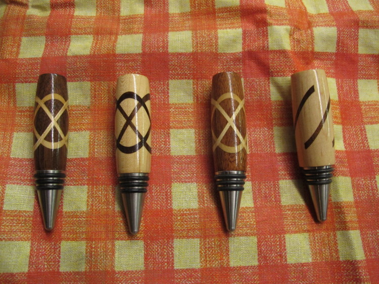

November 20, 201115 yr comment_37663 A sampling of some bottle stoppers Walnut/Maple, Maple/Walnut, Sapele/Maple and Maple/Walnut. Poly gloss finish. Stainless Steel Stoppers from http://www.torne-lignum.com/- Ruth is great to work with! Check her site!! Thanks for looking, Lew   Report
November 20, 201115 yr Author comment_37669 Thanks, Charles!The one on the rite is really easy to do.LewCharles Nicholls said:I have got to figure out how to decorate my turnings like this or at least in a similar fashion. Here I am thinking my turnings are great, then i see yours and about drool!   Charles Report

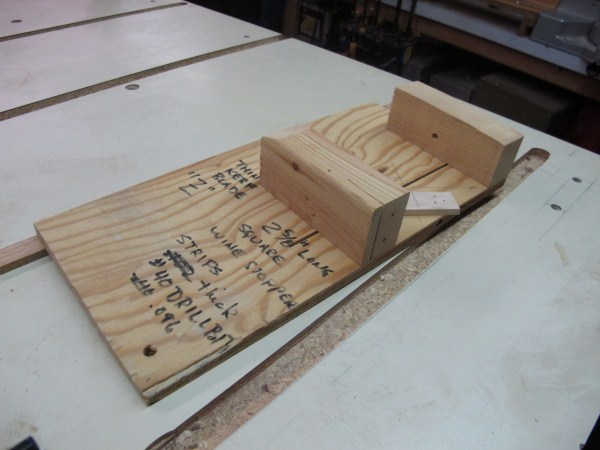

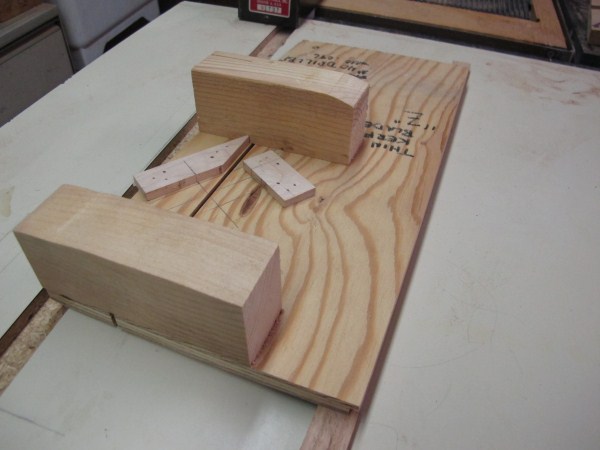

November 20, 201115 yr Author comment_37668 I made a quick jig to hold the blanks in the same orientation for each cut. Raise the blade to cut thru about 1/4 to 1/3 of the blank. The two large blocks on the jig were added after I made this last batch so there is no saw cut thru them, yet. When I make more stoppers, the cut will be there.  Lew  Charles Nicholls said: Do you just cut grooves in the wood then cut off color pieces to match?Lewis Kauffman said:  Charles Report
