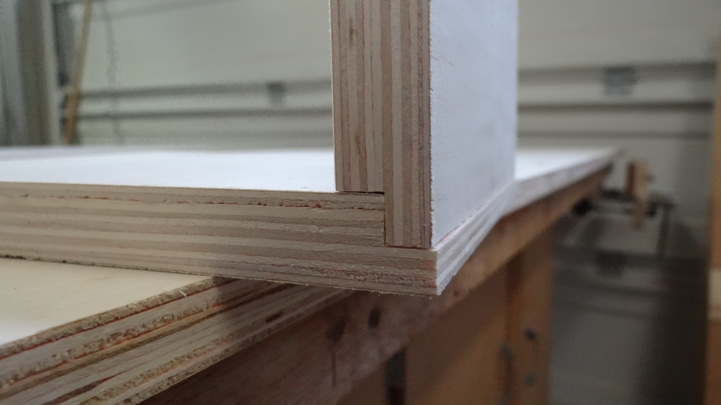

November 20, 201115 yr comment_37646 I'll give ya all a hint, I was trying to route a 3/8th's rabbet for the cabinet sides to join. What caused this bad fit? This is why I always do a test cut on scrap of the same material I am using. Â John Morris The Patriot Woodworker Report

November 20, 201115 yr Author comment_37654 Sorry guys, I had to edit the post, the operation was done to join two 3/4" pieces of ply. Not a test fit for the back panel, sorry. John MorrisThe Patriot Woodworker Report
November 20, 201115 yr comment_37653 If you are like me you blame it on dyslexia. I am always reversing numbers and reading the wrong "side" of the ruler. 5/8" becomes 3/8"- 1 1/16 is 15/16. Report
November 21, 201115 yr comment_37652 I'm willing to bet we have all done this. I know for a fact I have. Murphy is always around us just waiting. If I ever meet him in person, he is one dead $%#@#$%$#Â Wayne MahlerGod bless and protect our troops that serve so we can be free. Report

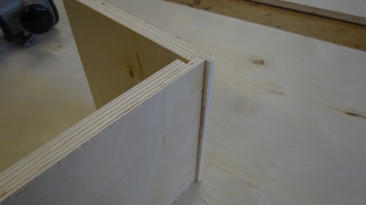

November 21, 201115 yr Author comment_37651 OK guys, here it goes. I was in high gear, and I grabbed the wrong rabbeting bit. My bits are in my router table cabinet drawers, and I have written the size of the bit next to each hole the bit is inserted in. Well turns out the 1/2" rabbeting bit was in the 3/8th's hole in the drawer. So I grabbed the wrong bit! I set the depth to 3/8th's and that don't work out too well with a 1/2" rabbeting bit when your trying to join two board that are 3/4" thick. Well, as I said, the perfect reason for test cuts! Here we go!!! Much better fit!!!!! The proper 3/8th's rabbeting bit was used for this cut. Thanks for participating! Â John MorrisThe Patriot Woodworker Report
November 21, 201115 yr comment_37650 don't you just hate it when those bits move around in the drawer when you aren't looking. Â But an excellent example of the test cut first. Â John MoodyJohn Moody Woodworkshttp://www.johnmoodywoodworks.com Report
