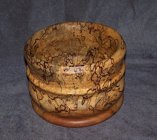

Lew certainly you would be the best judge of the piece of wood. I turned this spalted maple bowl and never had to put anything on it to stabilize it while I turned it. I know there are pieces that are different. I got this piece of wood as soon as they cut the tree down and turned it green and then trued it up later.
ning-spaltedmaplebowl-37475-96.pngLet us know how it turns out.
John Moody
