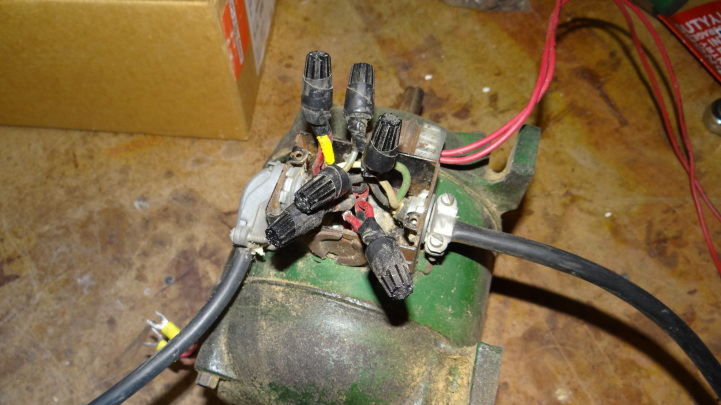

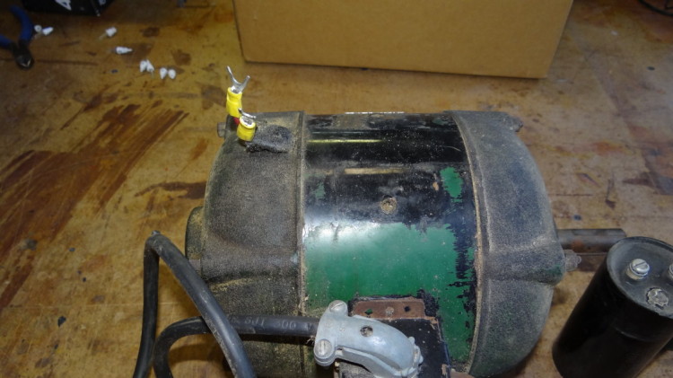

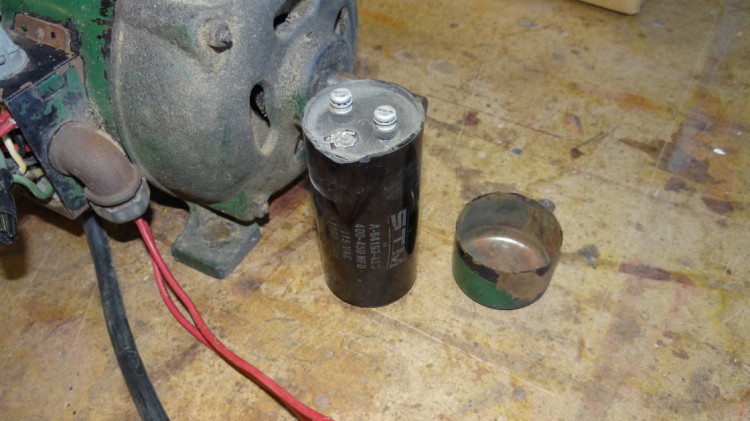

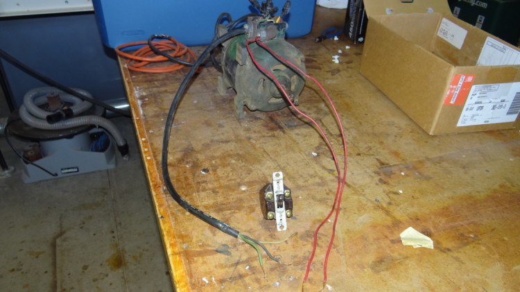

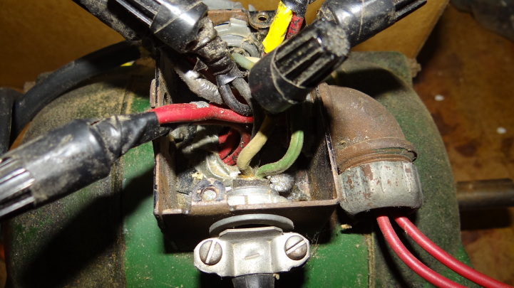

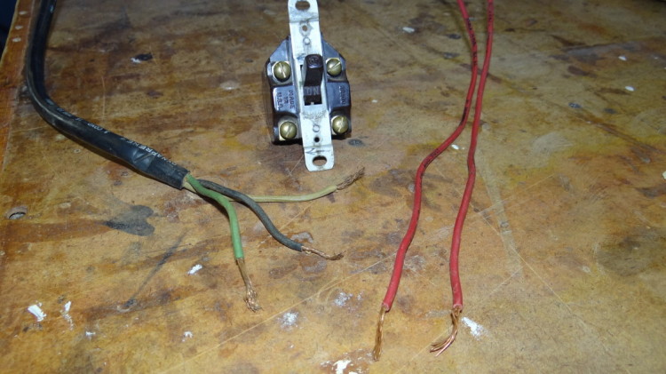

November 26, 201114 yr comment_37408 OK folks here is what I got. Larry Buskirk thanks for looking at this and anyone else who might take a stab at it. Here is the switch with wires. There are absolutely no markings on the switch telling me what wire goes where. Above pic is a far away shot of the motor and switch and wires. This next pic is a shot of what I believe to be a solenoid? And the small wire leads in yellow coming out of the top of the motor connect to this. Any help is appreciated! Thanks guys. I will be reading the WT Manual from front to back tonight, but if I could just get a little jump start on this process, I'd greatly appreciate it. Thanks   John MorrisThe Patriot Woodworker Report

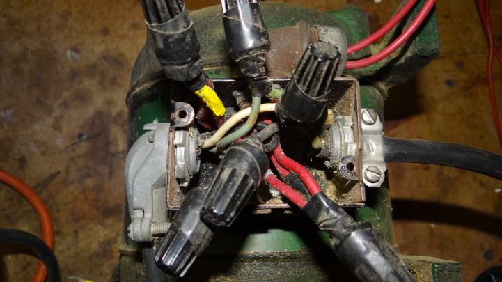

November 27, 201114 yr comment_37413 John,What you refer to as a solenoid, is your start capacitor, I'll need a better view of the wiring box to see the connections. But as it looks now, the black cord would get a plug, and the two red wires would go to your switch. But please give me a better view of the inside of the wiring box to make sure.Regards,Larry Report
November 27, 201114 yr Author comment_37412 Coming up Larry.Larry Buskirk said:John,What you refer to as a solenoid, is your start capacitor, I'll need a better view of the wiring box to see the connections. But as it looks now, the black cord would get a plug, and the two red wires would go to your switch. But please give me a better view of the inside of the wiring box to make sure.Regards,Larry John MorrisThe Patriot Woodworker Report

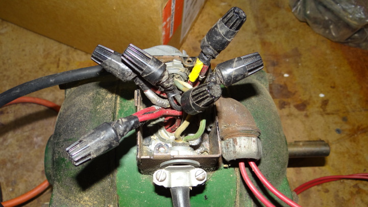

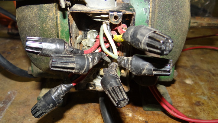

November 27, 201114 yr Author comment_37411 Larry, here a couple shots of the inside of the wire box, it is really crowded so I took multiple shots. I don't know if your going to be able to determine anything by this but I gave it my best shot. Larry Buskirk said: John, What you refer to as a solenoid, is your start capacitor, I'll need a better view of the wiring box to see the connections. But as it looks now, the black cord would get a plug, and the two red wires would go to your switch. But please give me a better view of the inside of the wiring box to make sure. Regards, Larry  John MorrisThe Patriot Woodworker Report
November 27, 201114 yr Author comment_37410 Larry, where do the Green, Black and White Wires go?Larry Buskirk said:John,What you refer to as a solenoid, is your start capacitor, I'll need a better view of the wiring box to see the connections. But as it looks now, the black cord would get a plug, and the two red wires would go to your switch. But please give me a better view of the inside of the wiring box to make sure.Regards,Larry John MorrisThe Patriot Woodworker Report
November 27, 201114 yr Author comment_37409 Here is a quandary I have. There are three units of wires coming out of the box, you'll see in the following pic. The black chord on the left is currently attached to a 110 plug. The two reds we addressed, and the black on the right house the three wires black green and white you see in the other pics. Â John MorrisThe Patriot Woodworker Report
