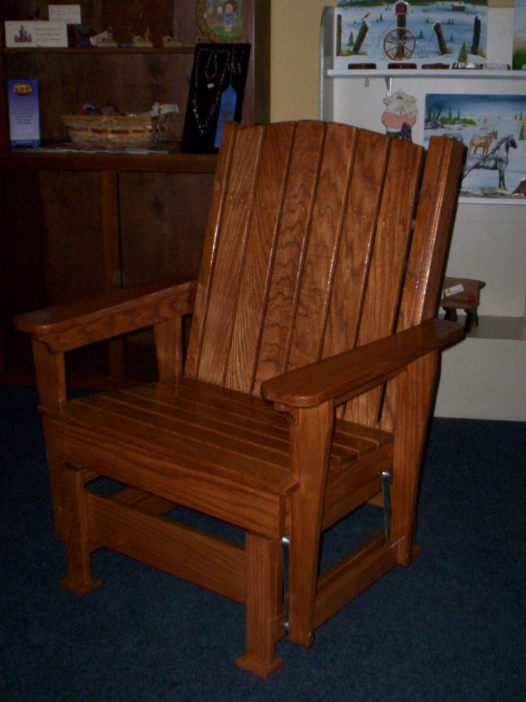

Good Morning Friends,
I have a client who wanted me to make a single chair glider as a gift for her father at Christmas so I looked for a double glider in a WOOD MAGAZINE and then divided it in half by eliminating the center upright of the double glider to end up with the one in the pictures I an going to show.
I hope you find them pleasing to the eye.

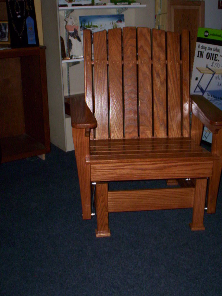

ning-redoakchairglider001-37296-27.jpg?wHere is another view;
ning-redoakchairglider003-37296-57.jpg?w

When I picked out the boards for this chair I saw right away how I wanted to arrange the grain to run as it does in the splats of the back of the chair and by placing them in the manner I did  truly shows the pattern out well. I didn't keep actual time on this project however I cut out the parts over sized to save on waste as I trued the boards up with a straight edge on the table saw in one day of about 6 hours. Then on the second day I laid out the patterns of the grain to give the effect that you see and clamped everything together so I could cut the curve on the top of the splats. Then marked the bottom ends as to which board went where and cut the curve on my band saw. Then continued on the balance of the parts to end the second day of about 6 or 7 hours.
Then came the actual assembly of the base and chair which I dry fitted over the base to assure I would have enough room for the glider parts. When that was done I stained and finished everything before drilling the holes for the glider arms.
All in all I would say I had about 20 hours in the entire project however if I were to make another one I do believe I could cut that time down pretty much especially if I made templates of said parts so I could use a pattern bit in my router.
I used Golden Hickory stain for the color and 3 coats of Minwax Tung Oil with two coats of Johnson's wood paste wax buffed to the finish you see in the pictures.
Thanks for your compliments for it means a great deal to me that others like what I build.
