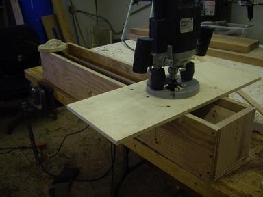

Here's the router lathe box with the router in place.
I used a Bowl Cutter to rout the cane.

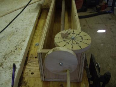

This is the crank end. Just turn the crank and move the router.

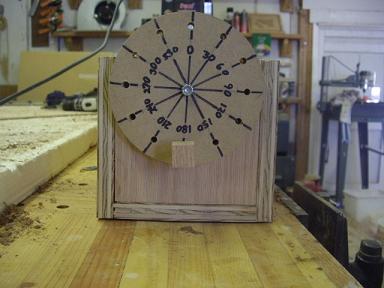

Here is the dial to locate the cavities for the inlay. The little square block is on the end of a 1/4" dowel through the dial and in to the box end.

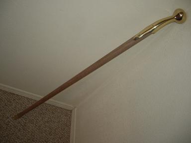

Here's the hame and end cap loosely fitted on the walnut cane. Good fit, by golly!
