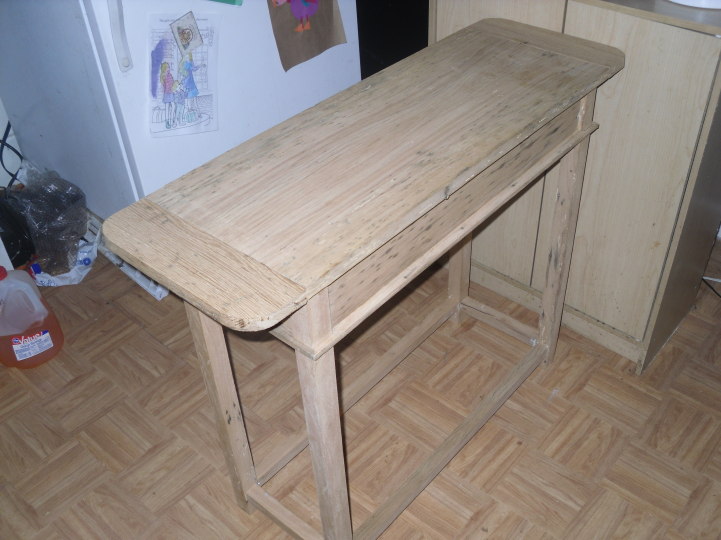

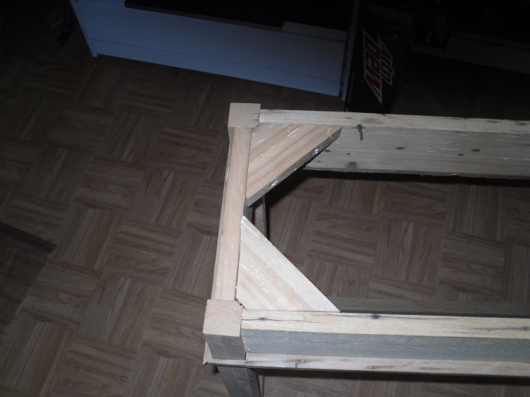

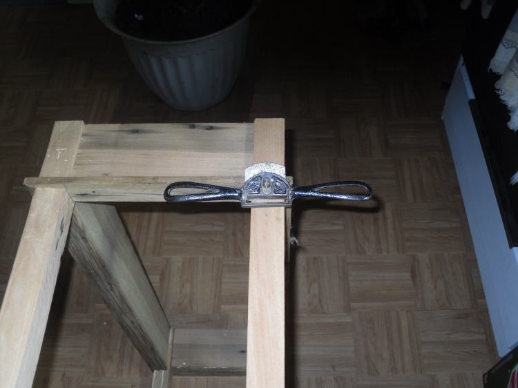

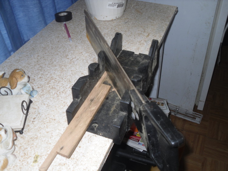

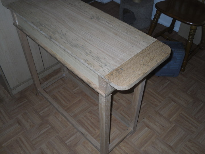

ning-sdc11921-37098-17.jpg?width=750Did a little sawing out in that COLD woodshop last night.   A few parts got made.   Breadboard edge was sawn.   Any tools that would be needed packed up.    Brought all back home, and started to work on it a bit today.   Breadboard still needs to be fitted.  Edging for the main aprons was marked out, and cut.   Mitered at my "Hi-tech Mitersaw":ning-sdc11923-37098-59.jpg?width=750Thin section will be glued in place to the leg,   a bead of glue along the apron, and a few nails to hold it in place.   Speaking of legs, needed to get rid of the saw marks, so another "Hi-Tech Tool" was used:ning-sdc11924-37098-75.jpg?width=750I think it was made by Stanley.    This also shows the beaded aprons.    I'll grab my block plane later, and bevel the edges of the beading.   I then spent about an hour on glue clean up.   Titebond dries a nice white colour, easy to see, LOL.   I also added corner blocks, these will also be my way of attaching the top. ning-sdc11925-37098-29.jpg?width=750Yes, that miter joint needs some work. Tongue.gif  I'll get thay when I bevel the edges.  I had to clip the inside edges of the legs with a chisel, made a better fit.    Those black streaks ARE nails, and their holes.    Oak does that to any iron product.    I haven't gone total hand tools on this, just about 1/2 way. Grin.gif  Well, enough, time to get off my break and back to work.   Stain will be an "Ipswich Pine".   Should bring out the grain nicely..Grin.gif

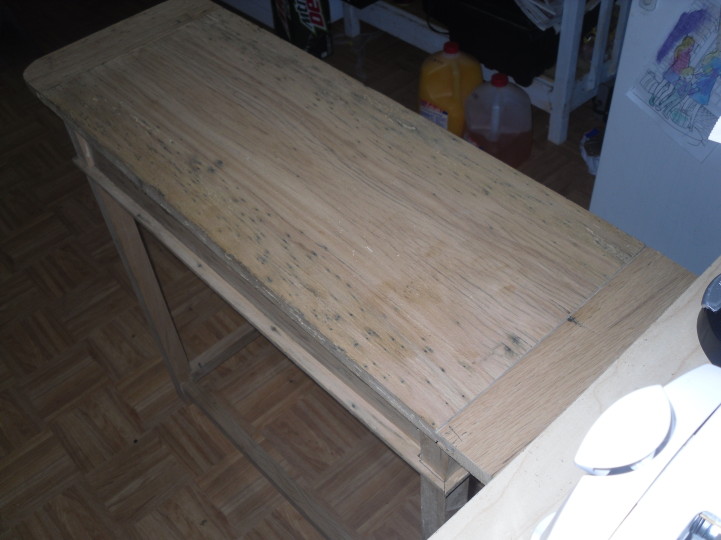

 A look at that top, as well:ning-sdc11928-37099-5.jpg?width=721Yes, I worked in the kitchen..ning-sdc11927-37099-11.jpg?width=721Kind of wormy.Grin.gifning-sdc11929-37099-44.jpg?width=721Although one hole did have a piece of iron still in it.  Frown.gif
