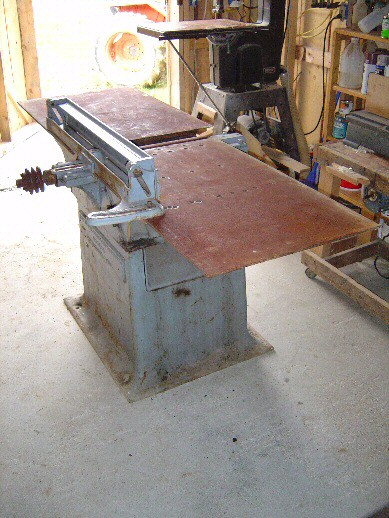

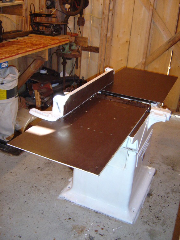

December 6, 201114 yr Author comment_37005 No this is an 18 inch wide, 2 knife cutter head and does spin on Babbitt bearings. I guess I just thought that the older line shaft machines were roughly geared for 2000 RPM but I might be wrong (I typically am). Here is a picture of the ole iron...Ken Rasmussen said:The 3 phase is an easy fix even without power company supplied power. But the lack of 220 is an issue. If you had the power a VFD will convert the 220 single to 3 phase and allow you to run a 3 phase motor at 100% output. As for RPM of the cutter head you should be looking to get it about 4000. How many knives are in the cutter? 3 knives will give you 12,000 cuts per min and 4 knives 16,000. 12,000 is a little on the low end. If this is a babbit machine I would not go over the 4000. As a for instance my jointer is a ball bearing 8" with a 4 knife head and with motor of 1745rpm, 10" motor pulley and 3" cutter pulley I am turning at just over 5000 and getting 23,000 cpm.My job is to give my kids things to discuss with their therapist Report
December 7, 201114 yr comment_37003 Very cool looking. Would like to see moreMy job is to give my kids things to discuss with their therapist Report
December 7, 201114 yr comment_37002 Travis,That looks like a keeper to me! I myself wouldn't sell it but put it to use. It would not be hard to put a gasoline engine on that machine. There is someone on ebay that has the clutch pulleys for the Delta sawmill, if I remember correctly the buy it now price is about $30.00. I'm sure you could scare up a used gasoline motor for not to bad of a price.Regards,Larry Report

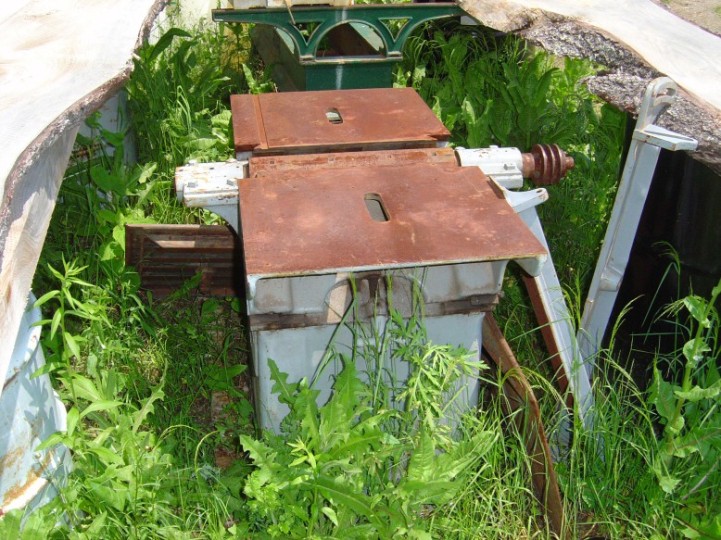

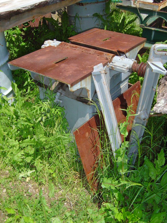

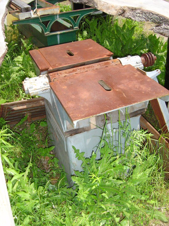

December 7, 201114 yr Author comment_37000 This ole jointer has an interesting story behind it. I was going through one of the many junk barns we have here in Maine with the wife. I did not see anything I liked that was reasonably priced, so we started to leave. Out by our car, and tucked in the weeds was this ole jointer. I took some pictures of it but was not too interested thinking like the rest of the stuff the guy had, he wanted way too much money for it. A few weeks later though I stopped in and asked him what he wanted for it. "That old thing, I don't know...a hundred bucks." I asked if it would fit on my Ford Ranger Pick-up, and he said, "if you got the hundred bucks it will." It did and so that is how I acquired it. I move it around with my little Kubota Tractor. Everything worked on it, it just needed a little cleaning and greasing, and of course a new coat of paint. I chose white because I dislike the navy gray it had. I checked the bearings but they were in mint shape, it just needed some shims to make the Babbitt bearings work a bit better. The only real thing it needs is a new set of knives as these are worn down to the adjustment slots, but that is an easy fix for a machinist by trade. Other than that it was an easy rebuild and feel I was lucky in that it came with the original fence. Overall I thought this jointer, used in the wooden shipyards of the day, would match up with our family sawmill and big ole planer, but just have not done much with it since getting it home. This is in part due to our sawmill (1901 Roberts sawmill) being down with a blown engine. We have a replacement diesel engine for the old 1965 327 Chevy that used to drive it, but that is another thread entirely!! Here are some pictures of it though. The green colored photos being what it looked like at the place where I bought it. Report
December 7, 201114 yr comment_36999 That's too cool Travis, what a great story too. How many of these ol dinosaurs are sitting in the weeds like this around the world. Incredible.John MorrisThe Patriot Woodworker Report
