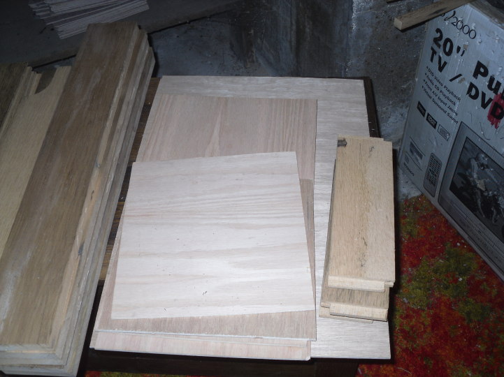

    Just a heads up.  I went out to the shop this evening, and milled up all the parts for a Toy Box.    No heat in the shop, so, EVERYTHING was packed up into the ol'Caravan, and taken back to the house.    I went out and spent ( Yikes, )  a bit of money on a 2' x4' sheet of 1/4" plywood.    Since the panels will be just plywood, might as well be Oak.   I still have to ASSEMBLE this "kit" in the basement, and glue up a lid for it.   The frames for the sides are some more of that old oak.

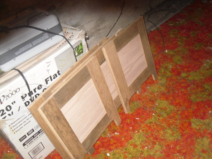

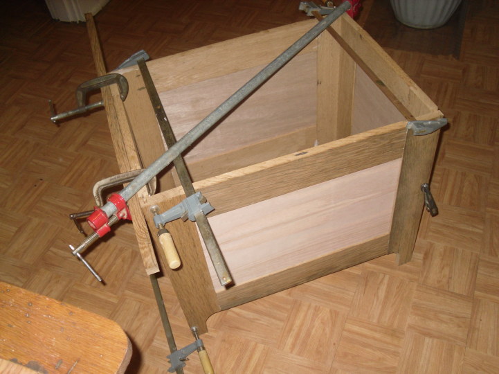

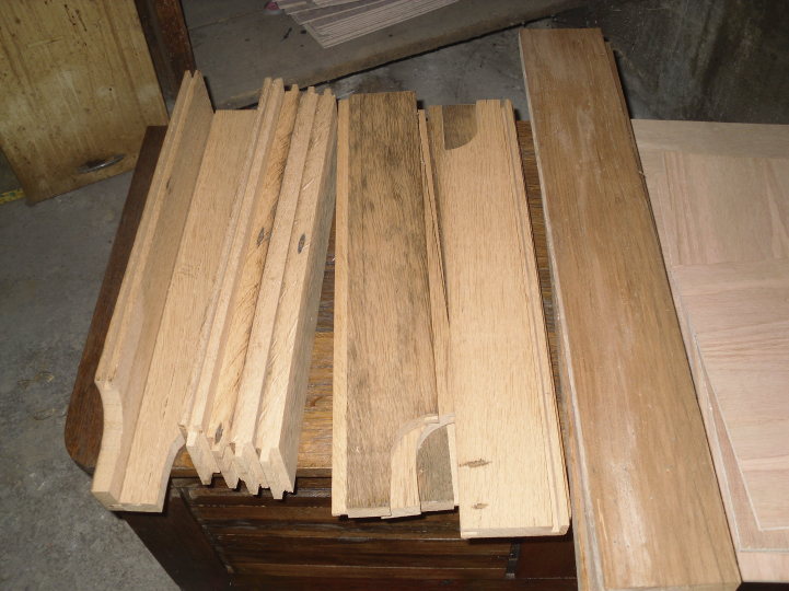

 Got some things done tonight.ning-sdc11943-36710-76.jpg?width=721Kit parts #1ning-sdc11944-36710-84.jpg?width=721Kit Parts#2ning-sdc11945-36710-16.jpg?width=721Frames assembled ( pay no attention to that old shag rug)   1/4" Oak plywood  in the frames.  ning-sdc11946-36710-16.jpg?width=721Test fit of the frames, still aways to go.   I moved it up to the kitchen because the floor was better.  ning-sdc11947-36710-68.jpg?width=721That diagonal clamp is to pull things square.    Still to make:   glue this box up, install a plywood bottom in it, glue up the 5 boards for the top, sand it within an inch of it's life,  install some hinges, and ask what flavour of finish they want.  Well, it's a start..Grin.gif

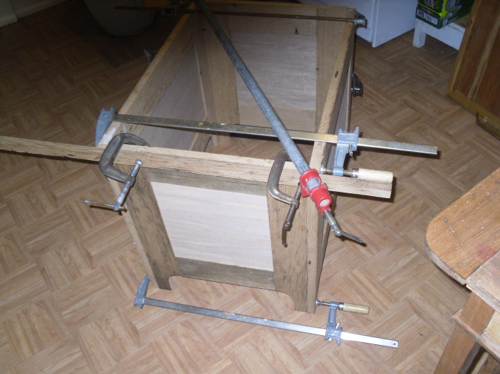

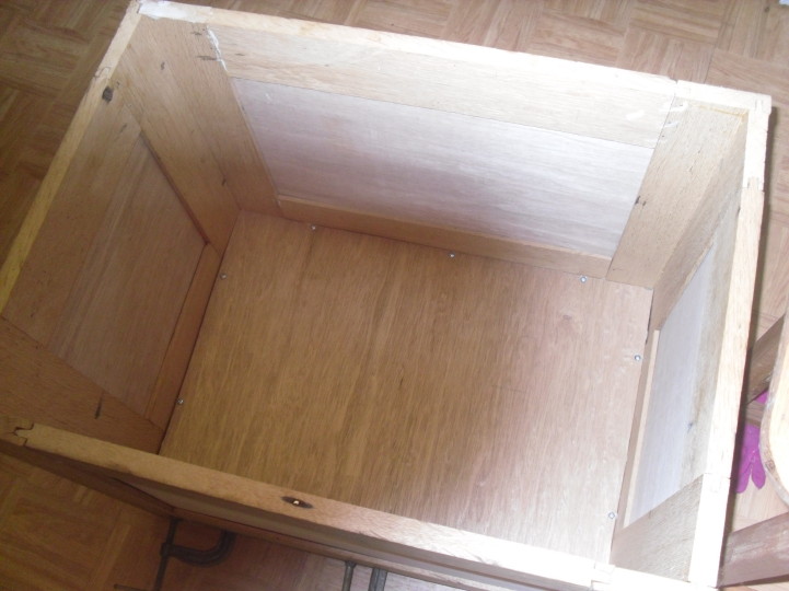

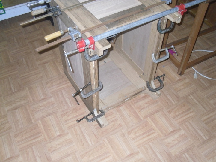

Morning work:   got some more done todayning-sdc11947-36707-25.jpg?width=721Glue up on the four sides, can't have too many clamps?ning-sdc11949-36707-54.jpg?width=721Bottom supports being glued in place.    Short ones for the ends will be screwed in place.ning-sdc11951-36707-95.jpg?width=721!/4" Oak plywood bottom, in place.     This afternoon, maybe a top will get glued up....Grin.gif
