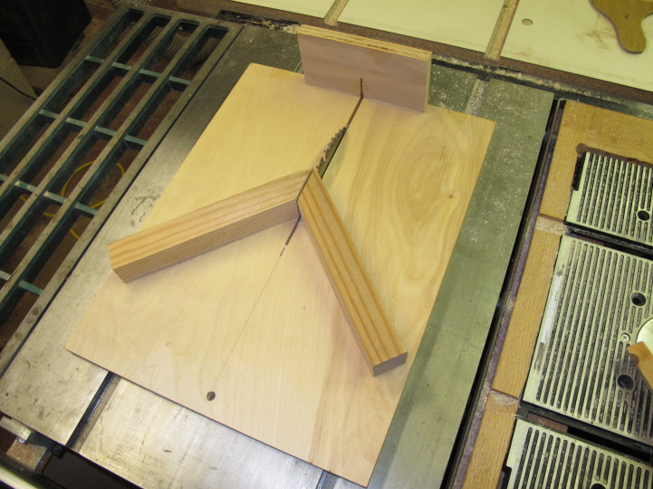

December 14, 201114 yr comment_36685 Similar to the one Wayne posted. This one doesn't limit the length of the material for either side of the cut. My fences are not very high but I don't cut crown molding with it. Lew Report
