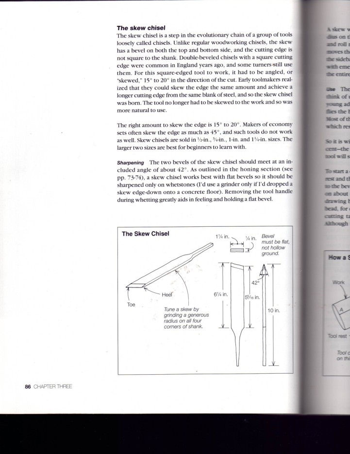

Is there a jig that I can buy somewhere to attach to the skews to get the proper bevel to sharpen by hand with? and what IS the proper angle for the skew, i'm hearing anywhere from 15 - 25 degrees

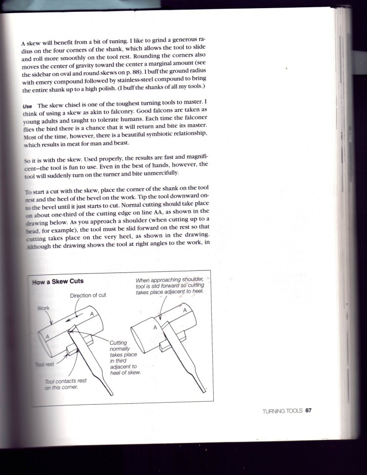

I found this information in one of my lathe books. I think you could use a protractor and make a guage-
ning-scan6001001-36492-87.jpg?width=721
ning-scan7001001-36492-38.jpg?width=721
Usually, I try and maintain the original angle for most turning tools. That being said, I did get a small spindle gouge that would catch regardless of how careful I tried to be. I reground the tip so the bevel was not as steep of an angle and that helped improve the tool's operation.

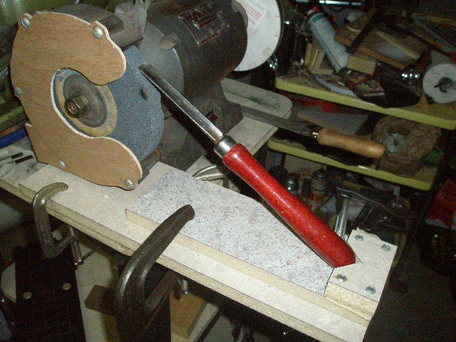

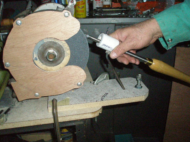

Hey Charles, looks like you got the FB share feature down!!!

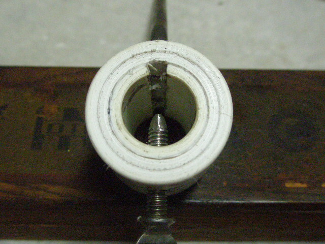

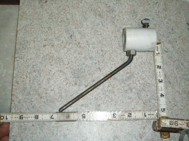

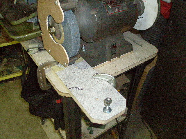

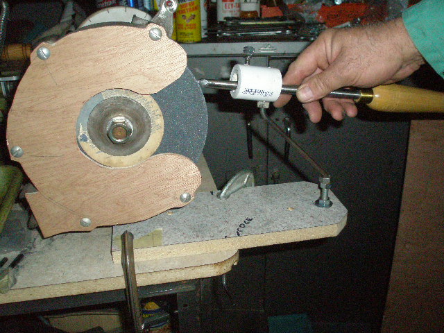

ning-p1012707-36490-70.jpgning-p1012709-36490-15.jpgning-p1012710-36490-8.jpgning-pc232649-36490-16.jpgning-pc242655-36490-96.jpgning-pc242652-36490-92.jpgYou guys might want to visit Capt Eddie's web site.  You can build his jig for just a few bucks and take the guess work out.  I built mine in one evening, and rebuilt it with a few modification in another.  Most of my materials I had on hand, but counting the sink cut-out, thumb screw, carriage bolt, pc of 34 pvc, 3/4 pvc coupling, 1" coupling, pc of 3/8 all thread, 5 nuts and 4 washers there can't be more than $5 if had bought new.  There are others other there on the net that do the same thing.  I have not made the attachment to grind a scew yet.  As you can see, I am using an old junk high speed grinder from a garage sale that was missing most of the guard parts.  This will become a dedicated tool and the wheel will be upgraded.  After grinding I used an oil stone to get a razor-sharp egde in just a few seconds.
