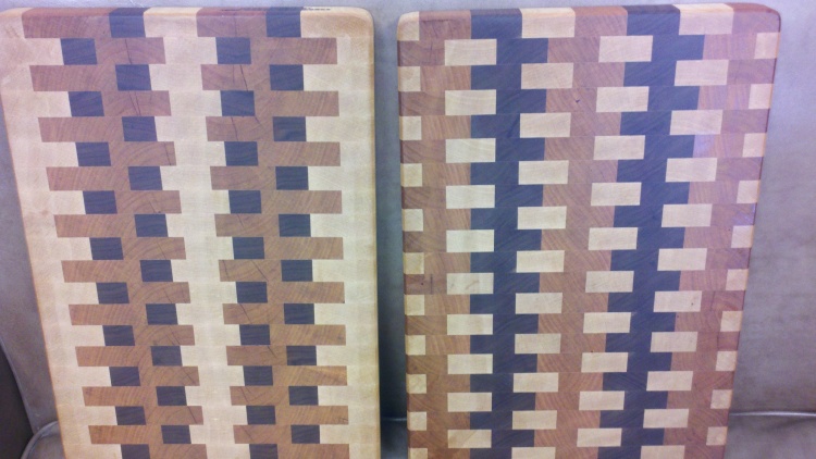

This is the next to last batch of cutting board to go out. I will have one more group ready to be picked up tomorrow and that will fill all of my orders before Christmas.

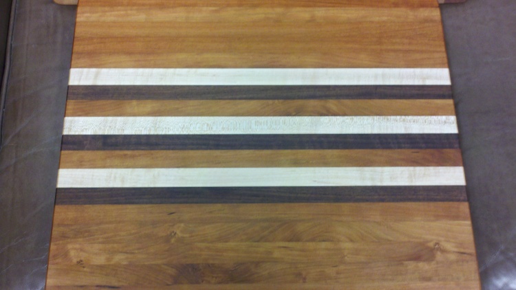

ning-20111221-091814-381-36394-92.jpg?wiThis one was a special order. 16" x 18" edge grain board.

Beautiful work, John!
Do you have a surface/drum sander to finish these or do you sand them with a random orbital sander?

Thanks Charles for the complement on the boards.

Beautiful boards once again John, That is one thing I wish I could make but don't have the tools to make them.
Thanks Lew,
Yes I have a 16/32 drum sander that I use to make sure they are level and to remove the glue after they come out of the clamps. I start with 36 grit then 60, 80 120 on the drum sander then 120 and 220 on the Random Orbital Sander and then 400 grit wet/dry on the finish sander.
