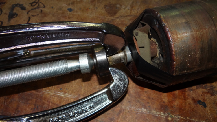

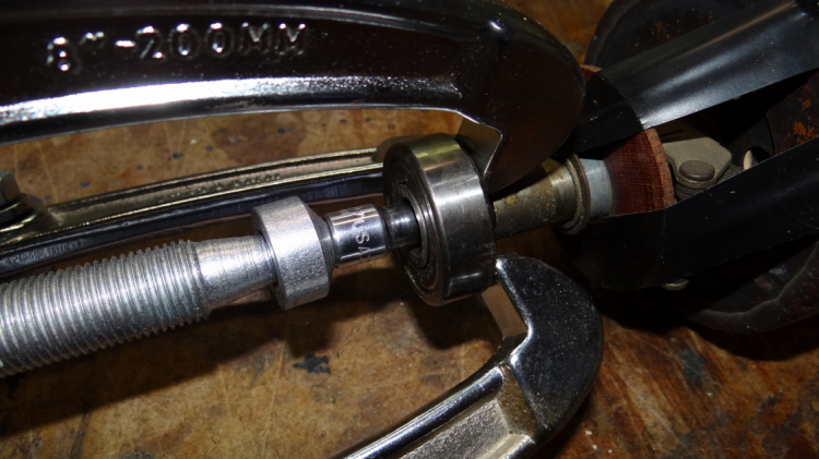

Well the dust finally settled after our Christmas and helping ma find a place to live. I was able to get back in the shop and do a little more tear down on my Walker Turner Driver Line Series Drill Press. Last night I worked on removing the bearings from the drive shaft both front and rear.  The rear wasn't all the bad but the front bearing was the main noise maker so I am hoping once these get replaced, the motor and overall sound of the press will be much quieter.
The first pic is showing the new Bearing and Gear puller I purchased on Ken Rasmussen's suggestion. The puller is already attached to the bearing ready to be pulled off the shaft. Getting one of these pullers situated on a small bearing is a rather cumbersome job, I could have used a third set of hands getting the pullers on and tightening the screw at the same time. I got it on though and once on, it's on.

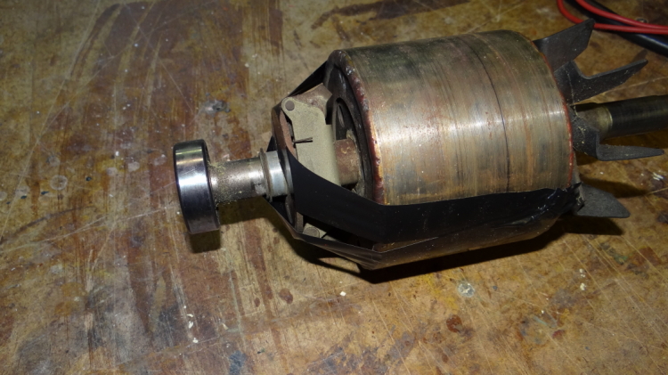

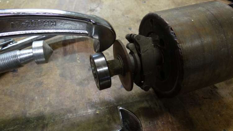

ning-walkerturner4-36075-75.jpg?width=75ning-walkerturner6-36075-39.jpg?width=75Now for the rear bearing. As you can see the clutch plate was in the way I had to tape it back for this operation.
ning-walkerturner10-36075-82.jpg?width=7Clutch plate taped back.

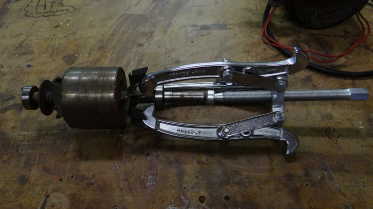

ning-walkerturner25-36075-6.jpg?width=75Now I have room to install the puller

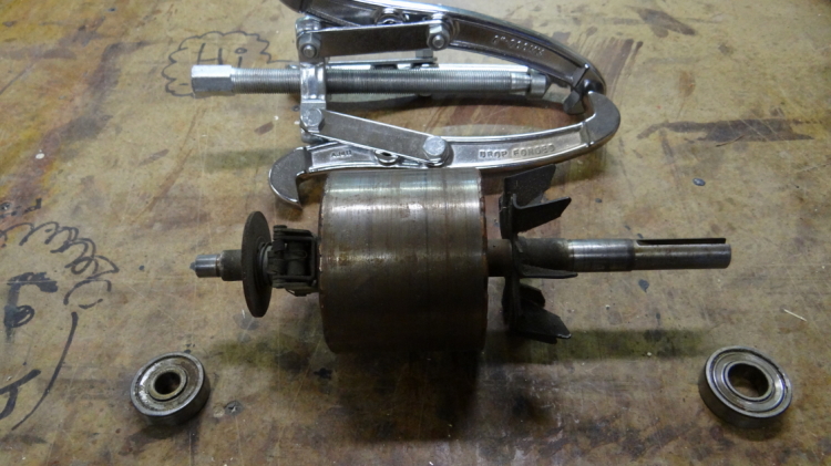

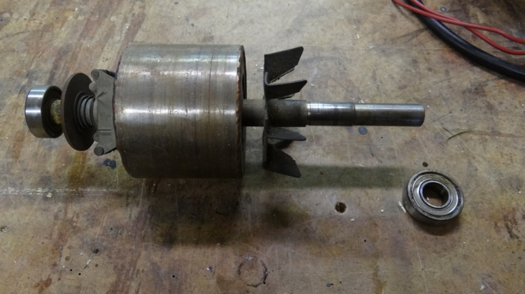

ning-walkerturner26-36075-34.jpg?width=7I ran into a little fubar while pulling the rear bearing. Since the rear bearing was mounted at the top of the shaft, the tip of the puller was hitting the inner race preventing it from coming all the way out. So I had to get creative, I just grabbed a small socket with a diameter smaller than the inner race use it as an extension so the bearing could slide off over it.
ning-walkerturner28-36075-78.jpg?width=7And there we go! Both bearings removed and ready for a call to the bearing specialist for replacements.

The small sprocket trick is a good one. Have seen old timer millwrights use that one. Sure wish i could find some old equipment to refurbish around here.
Thanks again.
Hey Russ, I didn't know what I did had a name to it! The Sprocket Trick. Cool.  I tried a few things before I landed on that. I tried a wood dowel, duh, it cracked and disintegrated, I was tired. I tried something else can't remember what it was and then I landed on the idea of something small and very hard and the socket came to mind. Thanks Russ!
