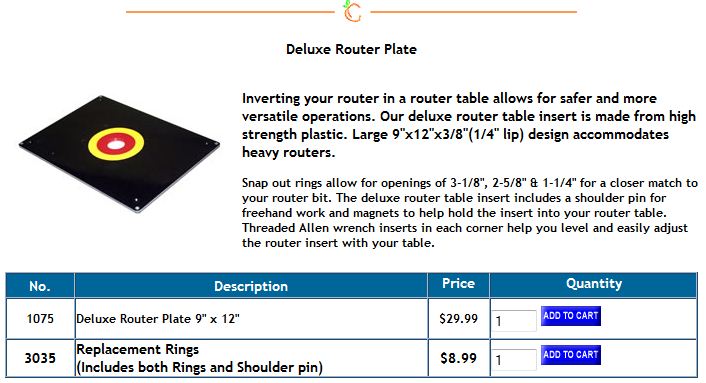

I made a homemade table from ShopNotes Tools & Jigs. Do I need to buy a plate and mount it to the table then mount the router to the plate or do I just screw the router into the table?
Dan I bought an insert for my table and mounted the router to the insert. Although you can adjust the router from above the table it makes it easy to take the router out to change bits. Most of the inserts you buy will come with a template so you can cut out the opening in the table. One you have the insert, take the base plate off the bottom of the router and use it as a template to mark where you need to drill the holes to mount the router. Don't forget to drill a hole for the router adjustment hole.

Dan, you need to get a plate of some sort and attach the plate to the router so you can drop it in from the top like John is talking about. Mounting the router to the underside of the table is limiting in a couple of ways, the most important will be how high you can raise your bit. I made a router table from a couple of pieces of re-purposed counter top and a router plate from a $2 plastic (UMV I think) cutting board from Wal-Mart... but I'm cheap.

Does that router plate come with a template or do you need to purchase one separate. It does not mention one on the website.
Thanks
Dan
Dan, I believe it came with one. You might want to call their 800 number and just ask that. I do have a template at the house. I didn't use theirs since I had a Cast Iron table. That's what makes me think it came with one.
