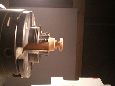

January 3, 201214 yr Author comment_35789 SQ--- I use an expanding mandrel in a collet chuck, and 2 different 4-ways, so I really wouldn't know where to start explaining it, and without pictures it wouldn't make a lot of sense anyway. My biggest problems was wrecking the finish on the inside while I was working on the outside and  vise versa. So now I finish sanding and put 2 or 3 coats of CA inside of the ring to be before I ever start shaping it. After turning and parting off the ring, I'll make a little mandrel out of whatevers handy to finish fine tuning the edges with sandpaper then sanding and finishing. . Here is an image of the mandrels I make to finish sanding and CAing the outside of the ring. I slide my ring onto it and center it so I can put the CA on the outside edges of the ring as well as the top... I want these things water tight, and since the inside is already done, as long as I don't sand through the finish I will be successful in that.     Report
January 3, 201214 yr comment_35788 Great pic Don and that picture explains allot for us. Thanks for clarifying.D. Kennedy said: SQ--- I use an expanding mandrel in a collet chuck, and 2 different 4-ways, so I really wouldn't know where to start explaining it, and without pictures it wouldn't make a lot of sense anyway. My biggest problems was wrecking the finish on the inside while I was working on the outside and  vise versa. So now I finish sanding and put 2 or 3 coats of CA inside of the ring to be before I ever start shaping it. After turning and parting off the ring, I'll make a little mandrel out of whatevers handy to finish fine tuning the edges with sandpaper then sanding and finishing. . Here is an image of the mandrels I make to finish sanding and CAing the outside of the ring. I slide my ring onto it and center it so I can put the CA on the outside edges of the ring as well as the top... I want these things water tight, and since the inside is already done, as long as I don't sand through the finish I will be successful in that.     John MorrisThe Patriot Woodworker Report
