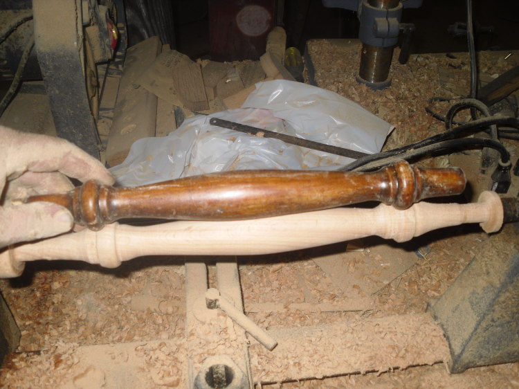

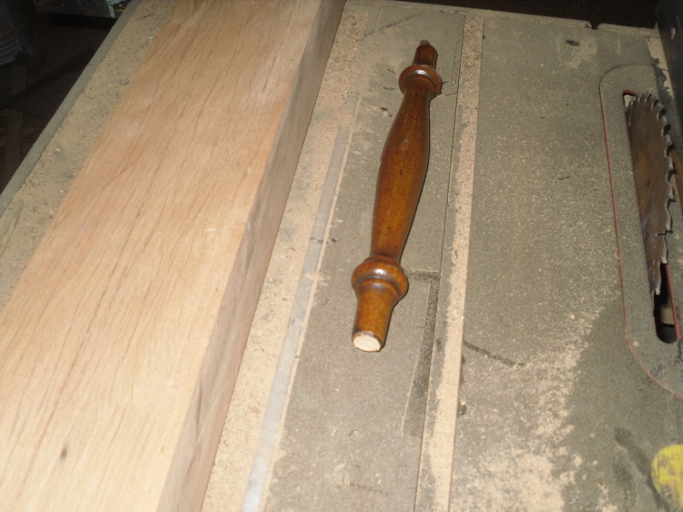

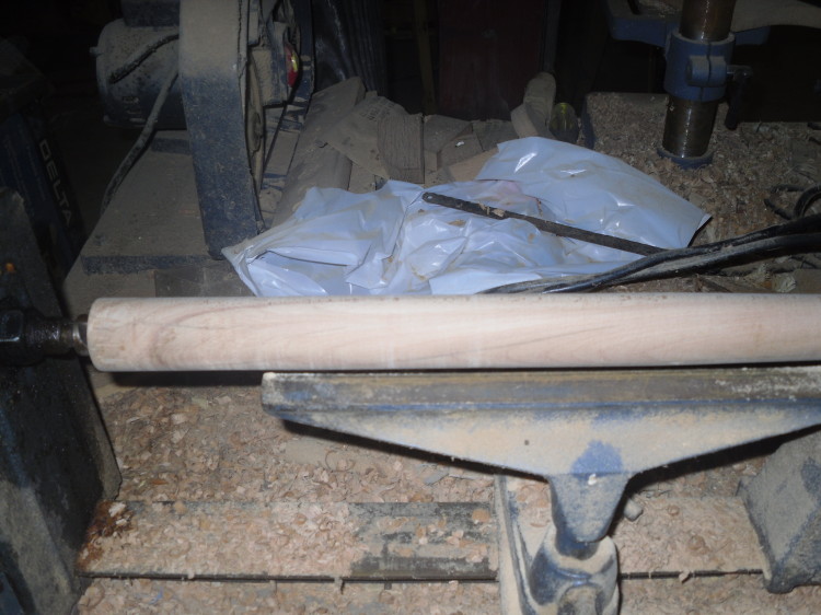

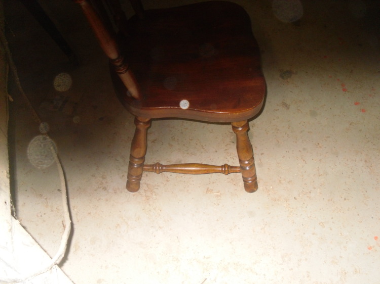

January 9, 201214 yr comment_35437  Mom had a chair, with a spindle that the tenons had broken off.   Asked me to fix the chair.    Said I would see what I could turn up.    Took the chair out to the "Barn".    Found some Oak I could rip down for parts.  I always rip double, in case #1 "blows up".Just an old rafter.  Now you see the broken off tenon.   Next, I turned a blank roundand then started to turn a spindle.  Once I had it close, I sanded and smoothed things down to match. As for the tenons, well, a Metric open end wrench made a good gauge ( it was the only size close to what I needed, that WAS in the shop.) Not too bad? Now, about that colour.  Early American is what it was called back then.   I had some dark walnut "witch's brew"  to try out. It took two tries to get things about right.   You know, flood it, wipe it, flood it again, and wipe it down sort of thing.  When the sandpaper part as done (before the stain trick) I grabbed an old chunk of Oak scrap, and burnished the blank nice and smooth. Then I placed the finish spindle in it's place, added a ring shank nail, and some Elmers to keep it there:Not too bad?   This was the first time in almost 2 years that I had run the lathe.  'and may the road raise up to meet ye' Report
