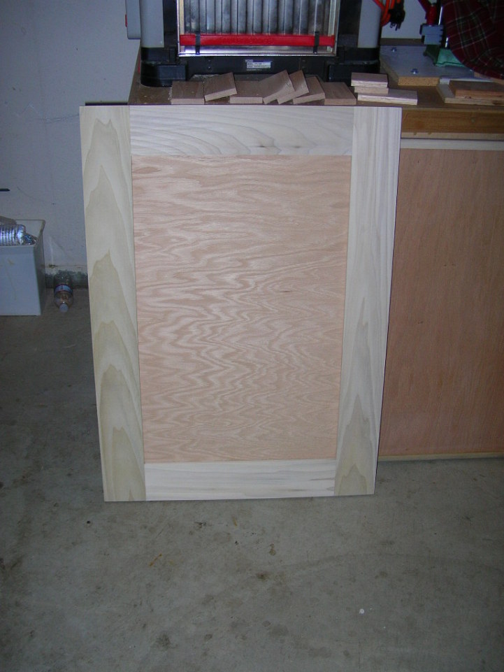

The frames will be minimalist and flat at 1" thick with nothing decorative on the edging. Just simple non-mitered frames that will have M&T joints or pocket screws (I can do either but my Harbor Freight mortiser is not real user friendly for more than a couple of mortises)
The measurements that I gave are for the lineal feet (2 sides and 2 cross pieces) which includes the total combined length of all pieces. The width is 1" wider to allow for trimming/squaring up. The thickness of the material will be 1" actual after surfacing and is sold by the lumber mill as being "5/4"

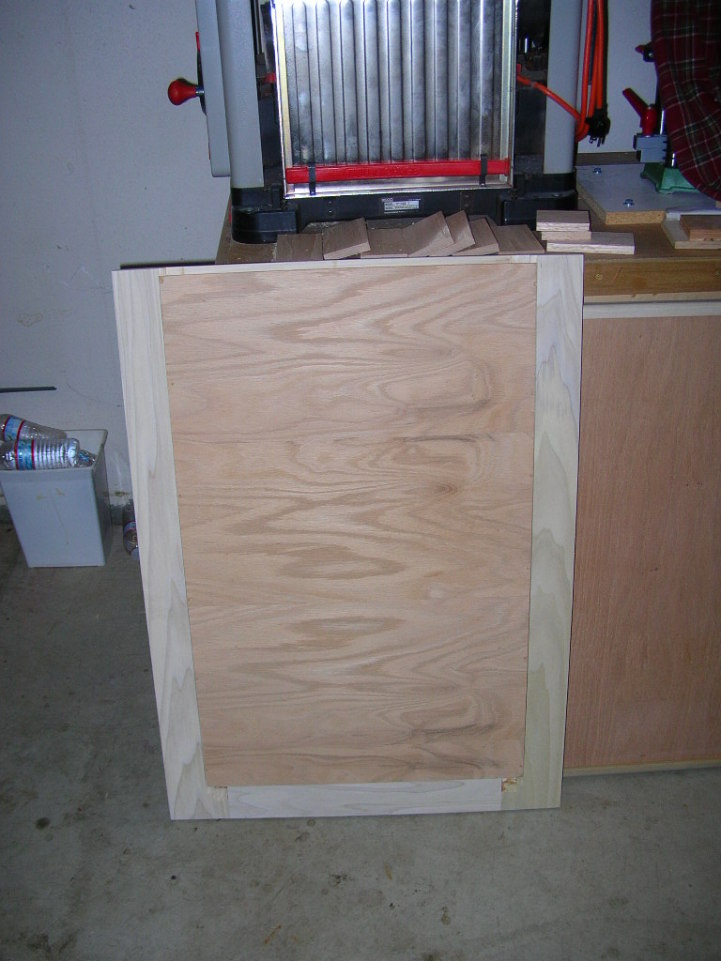

Here is a photo of the prototype of the smaller frame made from scrap 3/4" Poplar and Red Oak Plywood for the back. The larger frame will have the same construction but will be larger and square. The media will be installed from the top while hanging on the wall as it will have a plywood backing with the top cross piece milled down with 1" wide rabbits for the media to sit in.
This is the front side:
ning-dscn0261-35188-89.jpg?width=721
This is the back side.
ning-dscn0262-35188-65.jpg?width=721
