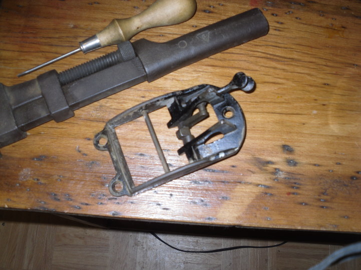

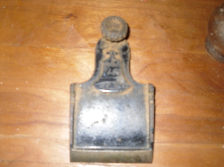

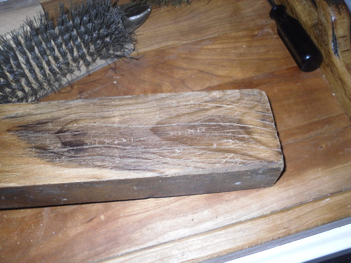

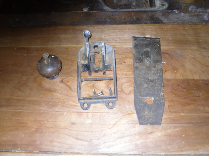

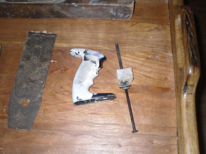

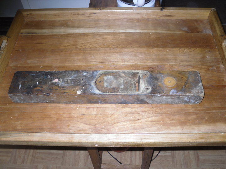

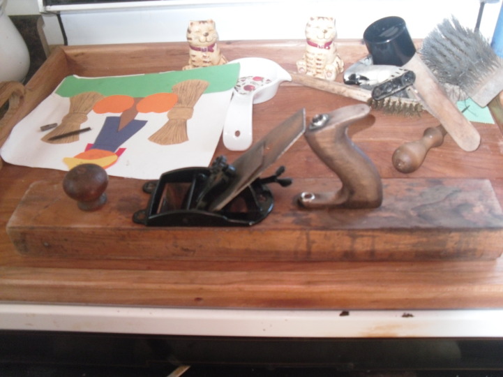

 Disassembly photos:ning-001-34901-1.jpg?width=721a naked body!   This is the wooden part of this old plane.   It has been a LONG time since it was like this. ning-002-34901-70.jpg?width=721Front Kanobi with a screw.   Blade adjustor assembly.    Blade/chip breaker.    Needing a GOOD cleaning.   Blade will get a good sharpening as well.  And now, the UGLY..ning-004-34901-79.jpg?width=721this WAS the tote on the plane.   Big old screw as well.  And something better to look at:ning-003-34901-17.jpg?width=721I need to clean this up as well.    That is a casting of a Liberty Bell.   I guess this is called the cap iron?    That thunbscrew tightens the whole shebang up.   This weekend, I should get a new (to me) tote.   We'll see how it looks, and go from there.  I THINK the number on this plane is #127, or #129.   There is a small chip out right in front of the mouth on this plane.   It is in front of the opening, not behind it.   When I clean the body up, I'll see how bad it is..

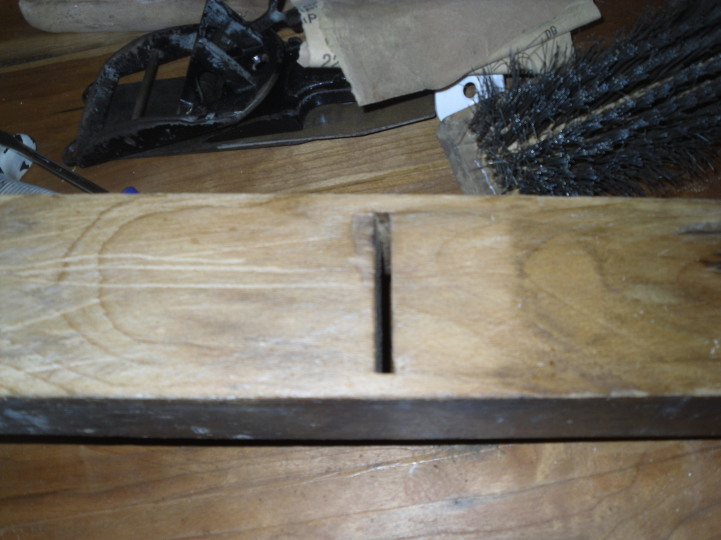

 Not much to show, right now.   Cleaning off several YEARS worth of crud.     Found a small chip out in front of the mouth opening.   It is not behind the blade so it might be alright. Chip breaker needs a little work, to sit flat on the iron.    Iron needs to see a sharpener soon.    I will get to that when I do the rest of the plane irons I have.
  Body is OLD!   The plane's that is.   ( Mine is too) A few checks in the wood, a lot of blackened areas, and some paint marks.  Got most of the paint marks scraped off,  now a matter of sanding the whole block of wood down.

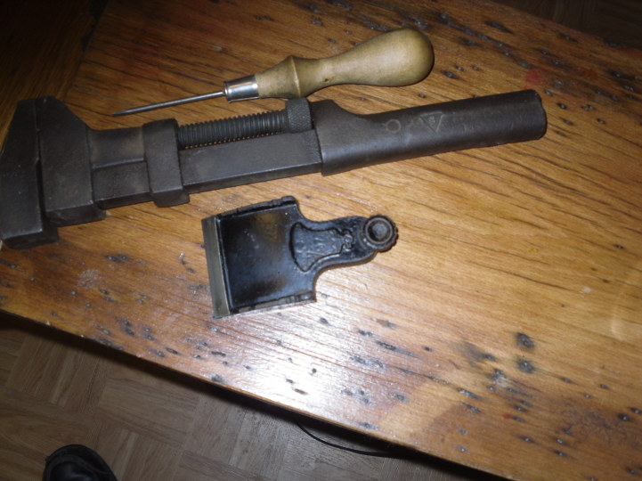

  Got the adjustor cleaned up last night at work, along with the "cap iron".      Need to get the rust cleaned off, primered, and gloss painted.    I also took along an OLD Billings/Coes "Monkey wrench to clean off.      Simple Green soak half the night, with a brass brush scrub.    A shot or two of WD40, and they came back home.    12-1/2" long Monkey wrench!    Photos of THAT tomorrow, got to go to work tonight.

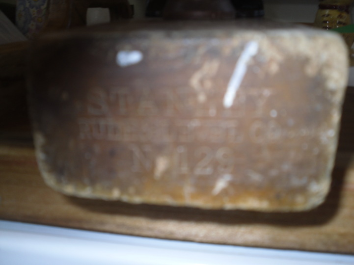

 A little research on this plane:    It IS a Stanley No.129.    From the stamping on the body's front edge, it is from 1888-1892.  Wood does have a few checks in it, but not bad.     Debating a new sole for this plane.     A chip out near the mouth, and a  worn corner near the backend.   Not real bad, not perfect,either.    Decisions...
 Got the rattle can of black enamel tonight, will be spraying things up later.    As for the clean-up, Simple Green does a nice job, with a brass scrub brush to move the grime away.  A photo or two, before the paint goes back on:ning-monkeywrenchplane003-34897-42.jpg?wthe adjustor assembly...ning-monkeywrenchplane004-34897-91.jpg?wTHE Liberty Bell, and a look at the bodyning-monkeywrenchplane005-34897-31.jpg?wthe chip out area (not too bad) and a look at the checky endning-monkeywrenchplane006-34897-94.jpg?wyou should look so good at 100+ years old!Grin.gif     Just surface check, nothing deep.  Be back later after the paint dries....

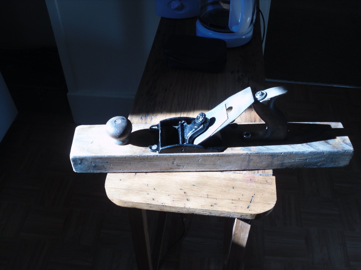

 Yep.   I just needed to remove the gunk that the Simple Green bath loosened up.    Steel wire brush would have scratched the "H" out of stuff.    I have got the "new" tote today.     Need to find some better screws to match.   Paint job is done ( for now) and the blade and chip-breaker are sharpened back up.  A couple photos to keep everyone happy...ning-libertybell001-34895-49.jpg?width=7Working on a sun tan?ning-libertybell004-34895-18.jpg?width=7Stamped into this end:  STANLEY      RULE & LEVEL  Co.      No. 129ning-libertybell003-34895-17.jpg?width=7All ready to go back to work.   Plane is a bit old (like me) and somewhere along the years, it picked up a nail in it's side.    It sits there nice and flush.     I will leave the sole alone for now.

The tote is off a stanley #5.     Most any of the larger totes will work, #5-#8.     I needed a long screw to fasten the tote in place.   On these, the tote just screws right to the plane's body.

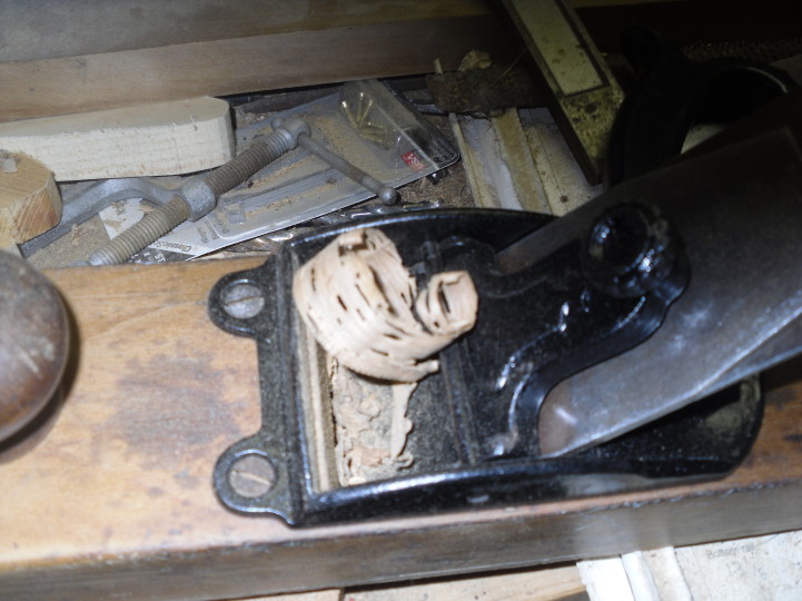

A little "Eye Candy".    I took this plane along tonight to the shop.  I was getting some oak ready to make a saw handle:ning-handsaw006-34890-78.jpg?width=721Looks like it works alright.  This is from the edge of a piece of oak 1x6.
