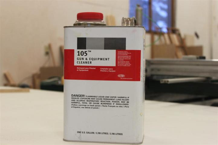

January 30, 201214 yr comment_34654 John, next time you stop at a auto parts store asked the if they have "105 gun and equipment cleaner". That what I've been using for cleaning my guns after using shellac and waterborne products. Work really well and won't hurt the plastic and nylon parts in your gun. It the bes cleaner I've found for the waterborne finishes.  John Moody said: Richard you are right on. I thought it was clear but after soaking it all night in DNA I ran a pin through the hole and got a small piece of dry finish right in the place where it makes a 90 degree turn. After clearing that it sprayed like it should. It just wasn't getting enough to allow it to flow as it should. I could get some air through it when I blew on it, but it was not enough to let the liquid flow. I was getting some finish out, just not enough to do a good job. Thanks for all of the suggestions and help. I know I will pay more attention to that in the future.John MoodyJohn Moody Woodworkshttp://www.johnmoodywoodworks.com Report
January 30, 201214 yr Author comment_34653 Thanks Richard, I will be sure to pick up some of that tomorrow.John MoodyJohn Moody Woodworkshttp://www.johnmoodywoodworks.com Report
February 6, 201214 yr Author comment_34652 Richard, do you know which auto parts store you got this at? I went to three different ones in our area and they had no idea what I was asking for. I even pulled up your picture and let them see it. Richard McComas said: John, next time you stop at a auto parts store asked the if they have "105 gun and equipment cleaner". That what I've been using for cleaning my guns after using shellac and waterborne products. Work really well and won't hurt the plastic and nylon parts in your gun. It the bes cleaner I've found for the waterborne finishes.  John Moody said: Report
February 6, 201214 yr comment_34651 John, I get mine a "Carquest Auto Parts. John Moody said:Richard, do you know which auto parts store you got this at? I went to three different ones in our area and they had no idea what I was asking for. I even pulled up your picture and let them see it.Richard McComas said:John MoodyJohn Moody Woodworkshttp://www.johnmoodywoodworks.com Report
February 6, 201214 yr Author comment_34650 Richard, that is funny, Carquest is the only one here that I didn't go by. I'll run by there tomorrow. I should have know. John MoodyJohn Moody Woodworkshttp://www.johnmoodywoodworks.com Report
