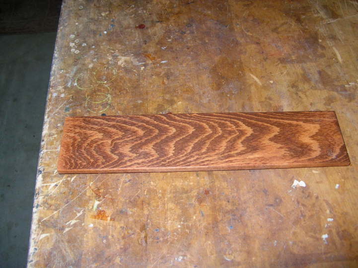

Ok, I finally got all 10 frames sanded down to 220 grit and boy are my hands sore (as well as the rest of me). The large frames (43"x43") took me about 40-45 minutes each to hand sand all the edges and ROS on the front and back with 80, 150 and 220 grit. The smaller frames (36"x26") took me about 30 minutes each. I went through and moved all the machinery and went "Bill Murray from Caddy Shack" and took the top off of my big shop vac and used it like a leaf blower to blow as much dust as I could out of the garage (my wife just had her car wash and now it has saw dust on it. Oh well). I had sanded down a chunk of the Beech to 220 grit like the frames and put a generous coat of the "Varathane American Walnut Stain" right out of the can to see how it looked. The wood really soaked it up and it came out pretty muddy. So I am thinking about doing a thinned first coat with mineral spirits to see if that would help with the muddiness. I have done that with oak before which worked out well, but I don't know what kind of ratio of MS to Stain would be appropriate.
Here is the scrap test piece. The color is spot on on my computer screen.

Color looks really nice. This board doesn't have the clear coat on it does it?
