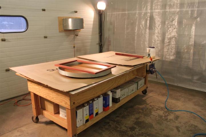

ning-spraybooth1-34283-59.jpg?width=721posted my temp spray booth before but I'll do it again for this new thread.
I do basically the same as John except I use reinforced clear tarp material hung on hooks spaced to match the grommets on the tarps.  I've also added a fan it the garage door window.
