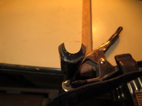

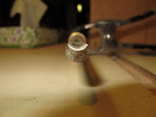

February 10, 201214 yr comment_34186 Let me take a couple of pix of mine and lets compare. A finger nail grind is usually not used on a bowl gouge.Charles Nicholls said: Actually these are bowl gouges or at least that is what PSI is calling them since they have the deeper flute on them, but the sides are too high and seem to catch on EVERYTHING, so I cant use but very light pressure or it hangs every time. Until I can find a way to put a fingernail grind on them I just wont use them at all, its causing way too much frustration for something that is supposed to be fun. I only have a 1" scraper that is a round nose and that doesn't even begin to cut the wood it just drags across it Lewis Kauffman said: Charlesnicholls61@att.nethttp://www.nichollswoodworks.comThis website is new so it doesn't have much to it yet but you are welcome to take a look Report

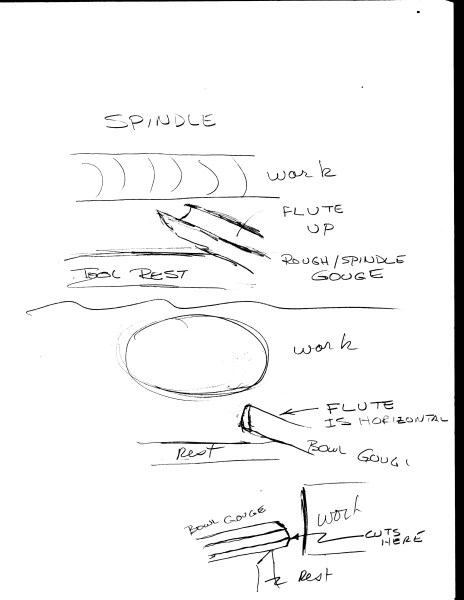

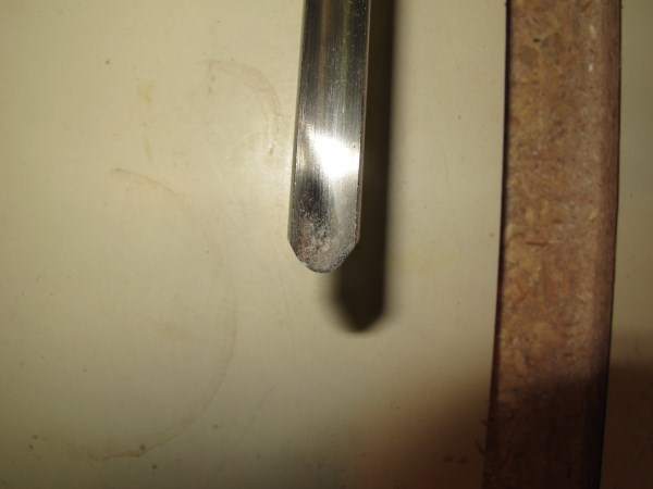

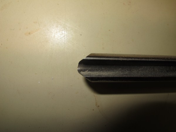

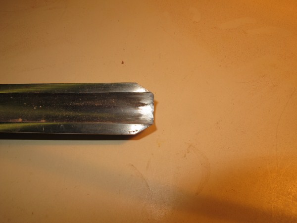

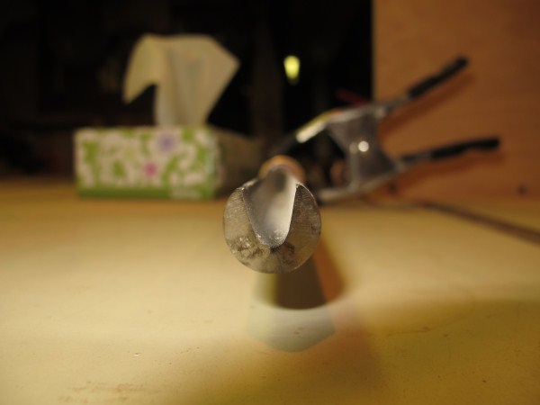

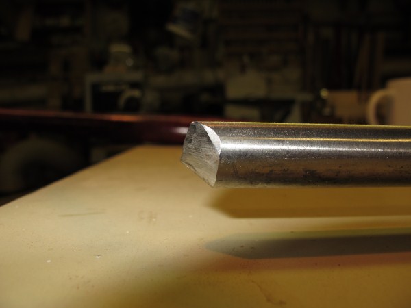

February 10, 201214 yr comment_34185 OK, looks like the gouge you have is similar to what I have. Here are some pix comparing my 2 types and a poorly made drawing of something I picked up out of a book. Roughing gouge top Roughing gouge end Spindle gouge top Spindle gouge end Bowl gouge top Bowl gouge end Bowl profile Please don't look at the poorly sharpened ends. Notice the flute on the bowl gouge is very narrow- compared to the other gouges and somewhat deeper. Also the end grind is rather steep, not like a fingernail grind. Something I was doing incorrectly when I started trying to turn bowls (all end grain turnings) was that I thought you presented the bowl gouge to the work piece in the same manner as the roughing or spindle gouge. I was getting a lot of catches. This poorly drawn picture illustrates, from what I have read, is the correct method of using the bowl gouge. Please remember, I am a self taught turner. I am sure the more experienced members will have even better ideas from their experiences. Charles Nicholls said: Here's a better look at what i have. Lewis Kauffman said: Lew-Time traveler. Purveyor of the world's finest custom rolling pins! Report
February 10, 201214 yr comment_34184 I have a smaller bowl gouge (3/8") like yours- just photoed the larger one for clarity. here are some scans from a book I have. I hope we don't get into trouble for posting them. Maybe they might help. Although the pix show wet wood being turned, the process is the same for what you wanted to do. However, you won't see those nice long curls with dry wood. My biggest challenge was to learn how to hold the gouge, where to start the cut and which direction to move the gouge. This type of turning is not as forgiving as spindle turning. I still do a LOT of turning with a scraper. Don't know if you have a grinder, yet, but if you do, you could make a scraper out of an old file. People tell you not to because the file is so hard and brittle but if you take it easy, they seem to work OK. I have made several scrapers/cutting tools from old, thick files and they have performed well- so far. Â Charles Nicholls said: I really don't see a difference between the 2 other than your gouge is larger than my 3/8. Maybe my eye's just don't notice a difference if there is one. All I really want to do is turn bowls and "boxes" of no more than 10" without having to fight to do it. Charlesnicholls61@att.nethttp://www.nichollswoodworks.comThis website is new so it doesn't have much to it yet but you are welcome to take a look Report
