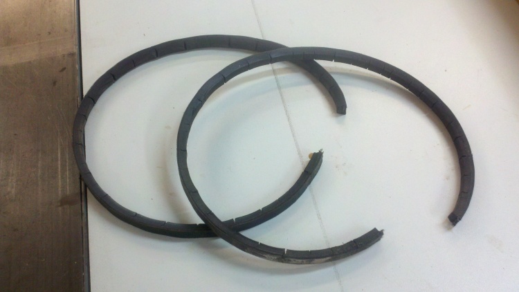

Put the board on my sled and start through the table saw. I hear a load pop, the motor is still running and the saw blade is not turning. I need to run about 8 inches of this board so I can finish tonight. I took out my blade insert and look down inside the cabinet and there are two belts, both broken into.

Now I got the belts out of the saw and I have got to get two new belts and get my table saw back up and running.
ning-tablesawbelts-34129-12.jpg?width=75Anyone have any advice on the best way to change these out? This is a Delta Unisaw 1987 model.

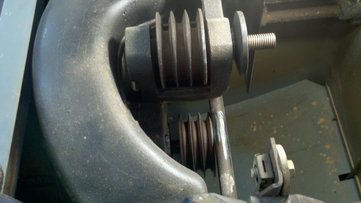

I picked up three belts at the local auto parts store today, but I also called Harbor Freight in Huntsville. It is about 60 miles away, but it is fairly close to my son-n-law so he ran over and picked them up for me. I will be at their house tomorrow afternoon for my grandson's 2nd birthday so I will have them then. So I guess I will put the link belts on the saw. I got it apart today and ready to put them on when I get home Sunday night. It appear the lower pulley had slipped on the shaft.
ning-unisawpulleys-34134-58.jpg?width=72So I loosened the set screws and moved it back in line with the upper pulley. So while I had it all open, I cleaned everything on the inside, put some graphite on.

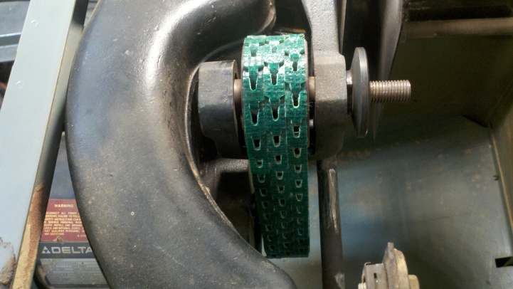

I picked up the link belts at Harbor Freight. As I understand there are at least two brands on the market. PowerTwist and Accu-Link. Accu-link is the ones carried by Harbor Freight. As I looked up information on them, it appears by the site I was looking at that the 1/2" Accu-Link is a little wider than the 1/2" PowerTwist.
I got them together and managed to get all three belts on the saw and tensioned.
ning-linkbeltsinstalled-34132-1.jpg?widtI ran the saw without the blade for several minutes and then checked everything. I had one link that came loose so I had to take them all off and fix the link, then replace them. Ran the saw again with no problems It does seem to be quieter, but then I have enough noise with the DC that it is hard to tell it if is that much quieter.

Glad that you are back up and running again. I hope you like the link belts. THey made a difference on my contractor saw.

I think I will be happy with them. I'll try to give them a good test this week and weekend.
