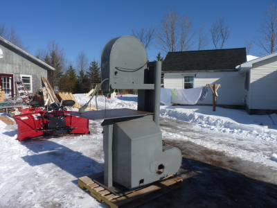

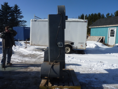

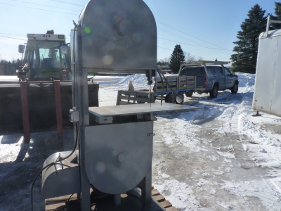

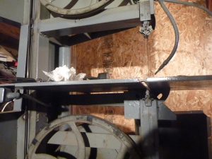

Grin.gifJust brought this home today.  Not sure if it is classified as a 24 or 26 inch saw, it has a 24 3/4" throat.  As far as i can tell it is a homebuilt unit constructed with factory parts.  It even has a 3 speed transmission as part of the running gear (complete with reverse).  Thanks for looking.

Nice Paul!!!
Paul, that looks like a factory built machine to me. I have seen saws like this before and I can't remember the brand. Some of that metal work in the body of the saw looks pretty fine to be a home built unit. You cannot find any markings on this saws cabinet?
Interesting looking saw. 3 speed? If so, im guessing a wood/metal saw. What size are the wheels? That will give you saw size
My job is to give my kids things to discuss with their therapist
I thought maybe a DO-ALL, but it would have a blade brazer on it. Anyway nice score!
i have to get it cleaned up some to look for any markings, but i still say  its a homebuilt. According to the guy i bought it from, he got it from a younger guy that said his grandfather built it.  Supposedly the grandfather was a machinist.  Also if it was from around Marquette my cousins fabrication shop is only 30 miles from Marquette..  the motor is a 1/2 horse craftsman, there is a wood idler wheel on the belt from the motor to the transmission.  The transmissior is from a vehicle not sure of the make yet but it is a 3 speed. Some of the welds on the support structure look pretty "bubble gummy" so i know that they are not factory.  Over all though it has good bones and something that i can work with.  On another note does anyone know if  the wheels need tires on them for the blade to run on, or on them style saws were they just bare metal. P.S. ill post some pics of the drive system.
I think they would have been leather or rubber, something for the blade to grip so it tracks.
Paul that is awesome. Nice saw. Wait what is all that white stuff around?

Nice saw Paul!  Is it 3 phase?
Ron Dudelston
Above and Beyond WoodWorks
Looks like a meat saw. I know it's not, but that's the first thing that popped into my mind when I first saw it.
I would think it would make a great dedicated re saw machine.
Wouldn't it be great to spend a few hours (days?) with the old gentleman that built it? What a wealth of Yankee ingenuity and info he must have.
Gene

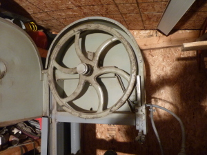

Paul....The wheels will need tires. It will help in a couple of different ways, tracking for one. They will require a crown to keep the blade running in the middle of the wheel. I would call Bobby at http://www.woodworkerstoolworks.com/, he will be able to help with anything you may need for the saw.
On the subject of tracking, I dont see any way of tensioning the blade. Are the tracking and tension adjustments on the bottom wheel? That would be another clue that is ho-made.

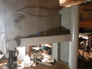

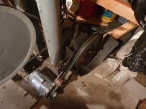

here are some more pics of my saw.   when i got it the motor was a 110 volt 1/2 hp 1 phase 1750 rpm, i just switched it tonight to a 3450 rpm 1/2 hp.  i believe it was originally built to cut metal, which i did do when i got it home even with a dull blade.   The tension screw is on the top wheel, underneath and behind the wheel.  the tracking adjustment is on the front of the top wheel.  The framework of the machine is made out of 3" x 4" rectangular tubing, there is even a piece of steel pipe verticle in the back of the machine.  The table is a solid piece of 1/2" flat stock.
ning-p1030260-34018-98.jpg?width=300
the tracking wheel is the knob in the center of the wheel, tension is in the middle behind the wheel

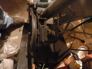

Picture of the running gear, note the 1/2 hp motor.
ning-p1030262-34018-27.jpg?width=300
pic of the cast iron 3 speed transmission

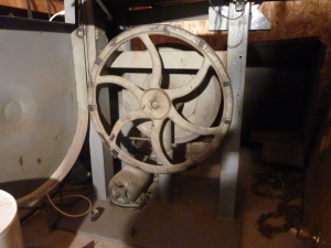

drive pulley behind the bottom drive wheel, made out of flat stock
ning-p1030264-34018-94.jpg?width=300
rear framework, note steel pipe column on right

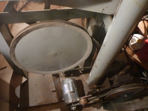

underside of the table
last picture is bottom wheel, motor to left is the one that came with it

Paul.....You might want to think about the motor switch. Here is a calculator to find SFPM. You will want around 4000 for cutting wood.
http://www.vintagemachinery.org/math/sfpm.aspx
