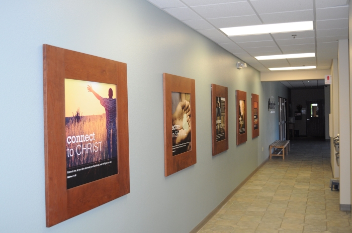

Last week I finally finished up the 5 large frames for church and delivered them to be installed. Today I put the final coat of spray finish on the 5 smaller frames and delivered them so they will be installing them  tomorrow. They are happy with the frames and they look great with the printed media that they put in them. I am still not happy with the final finish on the 5 large frames, but they are and that is what matters. So I shot some photos of the large frames now that they are installed and next week I will get some pictures of the smaller frames. It was a good project and I learned a lot including how to use dye and working with a new spray gun which improves my ability to finish future projects.
The large frames are 43"x43"x1" Beech. With the fluorescent lighting the frames appear much lighter than they are.

Allen, those turned out really great. Now it all comes together seeing them in the place they are in. Very contemporary and very well designed for the wall they are on. I love em, and the color turned out great! So, what did you finally do to fix your finishing issues>

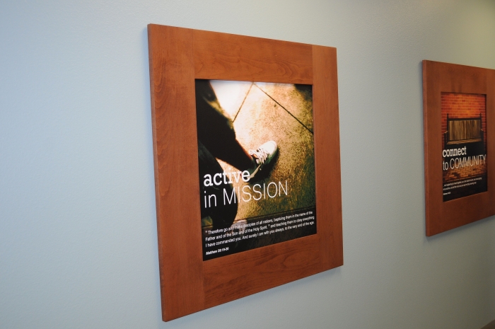

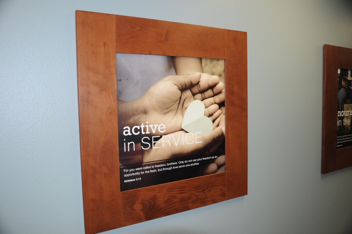

I started out with stain on the large frames, but it turned out uneven. I tried to do a top coat with some trans tint dye to even it out, but that didn't work either. So I had to sand them down to bare wood and start the process over. After doing a bit of experimentation, I ended up doing it with a trans tint dye using a mixture of 1 TBS to 1 Quart of water. With the wood so porous I had to dye it twice to get the colors even. Once it was dry then I did a seal coat of blonde shellac in a 2 lb cut and then sprayed 3 coats of a satin water based "Polyacrylic". Since I did the finish on the small frames after the large frames, I used dye only in multiple coats so the color turned out more even and just a hair darker. In appearance the large frames have more pronounced grain than the small frames. This is due to the stain that brought out the deeper grain pattern which didn't show up as pronounced with the dye only. But since the smaller frames won't be place next to the large frames, the color and grain variation is not a problem. If you look at the 2nd frame photo that says "Active In Service" you can see the really bold grain pattern on the bottom piece. That was the most difficult one of the 5 and gave me the most fits.
I did like using the dye, but I had to use 1 gallon of it since the Beech would soak so much of it up. I had to get a spray bottle and a sponge and keep it wet until it soaked in as much as it could and then wipe off the excess. It was a very messy process which left quite a few stains on my garage floor.
