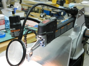

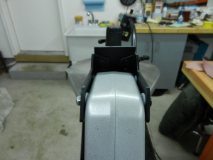

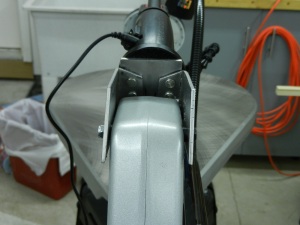

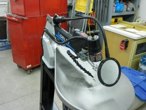

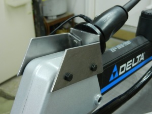

After purchasing a magnifier light and using it for a couple of projects on my scroll saw I found that mounting it to the arm or the table posed some problems so I came up with a more convenient mount that got the magnetic base out of the way and placed in an out of the way location that didn't interfere with the saws operation or controls but gave me the ability to adjust the magnifier to it's best focal length from the blade and there is no vibration transmitted to the light. This light works great and now it's even better. The bracket is a bit crude but it functions beautifully. I'll take the bracket to work and media blast and paint it and it'll look a lot better. It's made out of 1/8" X 2" steel flat stock a couple of nylon bushings, 4 steel rivets. $6.50 in material cost. Not too bad considering I cut all the pieces with a hacksaw and bent the side pieces with a hammer and a vice and the hand filed the rough areas.ning-dscn0083-33496-79.jpg?width=300ning-dscn0084-33496-76.jpg?width=300ning-dscn0085-33496-72.jpg?width=300ning-dscn0086-33496-15.jpg?width=300ning-dscn0088-33496-59.jpg?width=300http://thepatriotwoodworker.com/forums/uploads/ning-dscn0086-33496-15.jpg' target="_self">
Not bad at all Mike. Necessity breeds invention they say? This a great modification. And your handy work considering you didn't use metal work specific tools is pretty danged nice man!
That's pretty slick.
Gene
Great idea Mike. I'm sure some of the others here could use it too.
Greg
Scroll Saw forum host
http://www.thesawdustfactory.net/
Very nice Mike. That will sure make it easier to see and not be in the way. Great that it doesn't have any vibration in it either.
Good job!

Thanks guys. I may have to grind it down some so it doesn't look too bulky and crude. Hopefully I'll go to work tonight and grind it down and paint it during lunch.

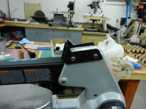

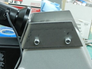

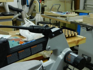

I trimmed the excess material away, primed and painted flat black to match the scroll arm and now the bracket looks more in scale to the saw. Almost as if it came with the saw!

Looks just like a factory made piece now Mike
