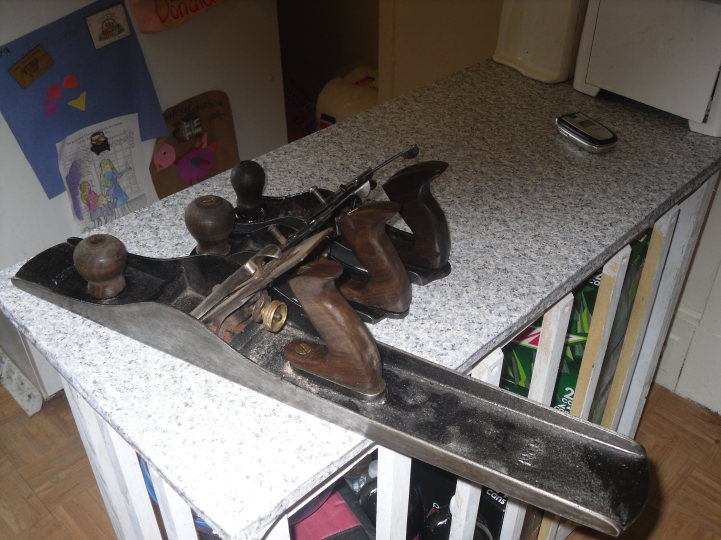

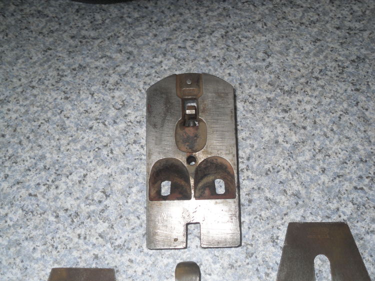

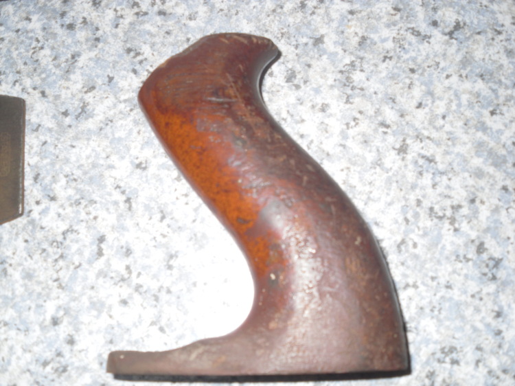

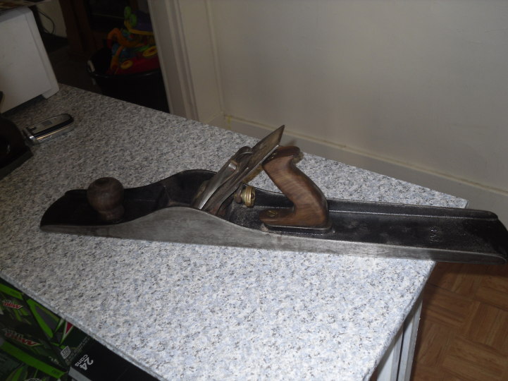

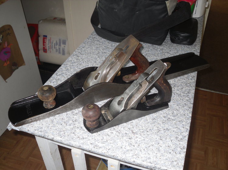

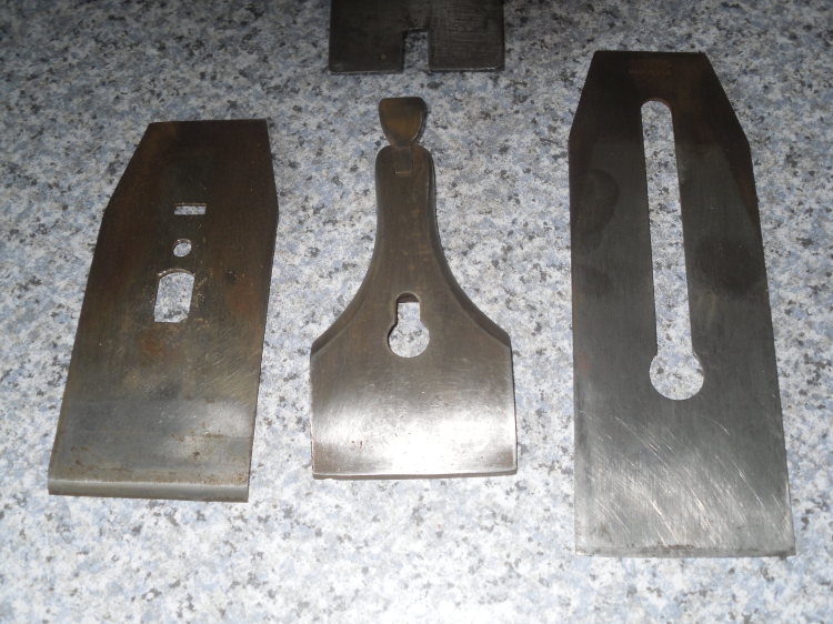

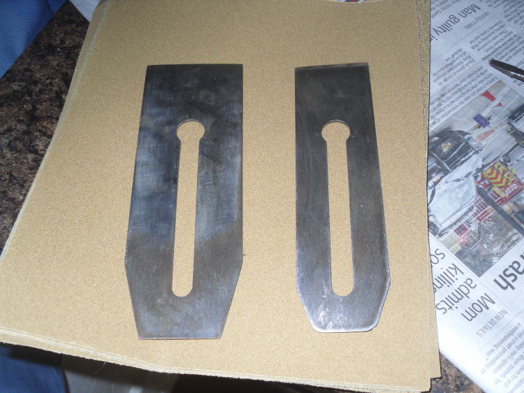

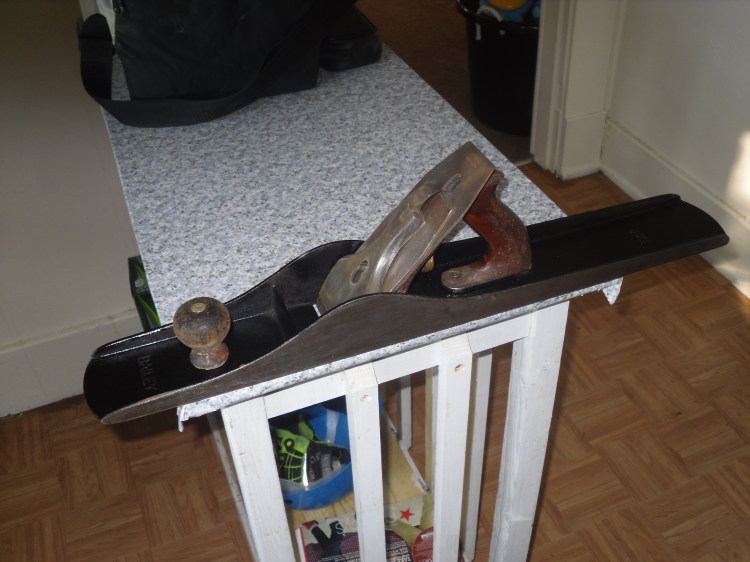

 Is almost back in service.    Blade needs a good sharpening, and those handles are very rough. Everything is cleaned up:ning-misterbailey001-33316-50.jpg?width=The "blade group",  That iron is HUGE!ning-misterbailey009-33316-76.jpg?width=An iron from a#4  is on the left, next a frogning-misterbailey002-33316-63.jpg?width=Couldn't quite get down in those holes, oh well. ning-misterbailey003-33316-3.jpg?width=7Ugly, ain't it?    This is the "stock" tote.   It will go back on, until new ones are made, and now for the rest of the storyGrin.gifning-misterbailey011-33316-7.jpg?width=7That is aDefiance #3 in front.    Meet Mister Bailey all 24" of him.    This is a type 9, Bailey #8c.   Anything this big will be called MISTER!   I do know where some Balck Walnut is stashed, just in case I get tired of those rough handles.   One more look at this guyning-misterbailey010-33316-49.jpg?width=Stamped into the side, just above the sole, are the letters "W" "R".     As soon as the blade gets a new edge, I'll take this guy for a test drive, or will he take me?Grin.gif

Looking good mister!  Hey Steve, I call my 8C My Girl. What do you think would happen if they both met?8.gif

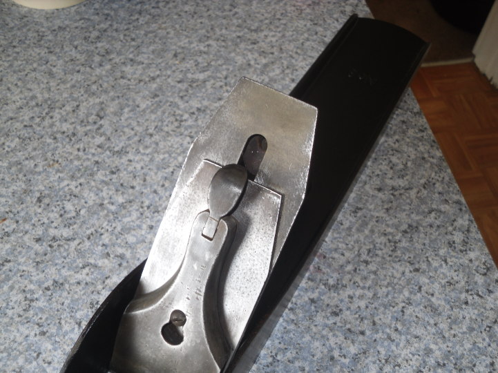

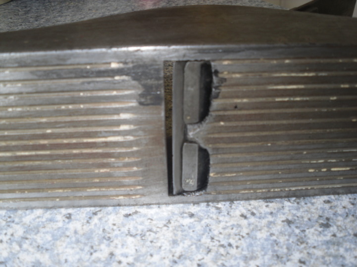

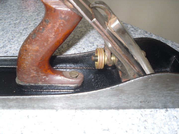

  Metal must have been real thin around the mouth opening:ning-bigmouth001-33324-50.jpg?width=721That is both the iron and the frog showing through.   This is the way I bought the plane.    The adjustor knob is solid Brass as wellning-bigmouth004-33324-44.jpg?width=721One more look at the blade group, all nice and cleaned upning-bigmouth003-33324-38.jpg?width=721We are getting there.   Blade is now almost sharp, getting a sandpaper treatment later.  Thanks for looking in.

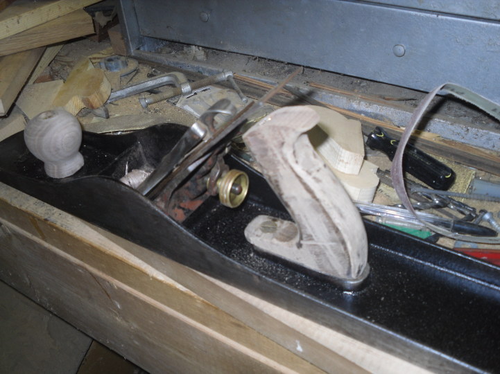

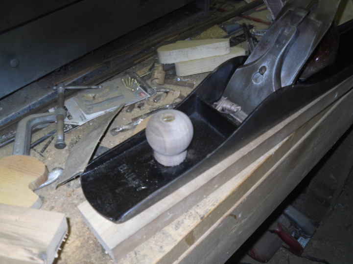

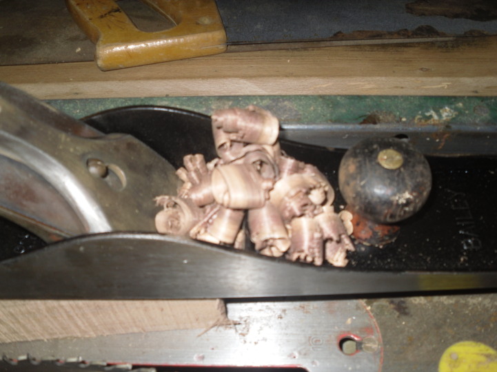

Going to TRY the shop today, and maybe tomorrow.     Taking Mister Bailey for a "test drive" on some Black Walnut, prepping it to make some handles.  I downloaded a few profiles from LEE Valley for the totes.    Knobs are the easy part, just put a blank in the lathe and watch the fun.Grin.gif  There is some 8/4 out there, so maybe a 12" long piece MIGHT come up "missing".   Planing on three handle sets.   One for an #8, one for a #4 sized plane, and a #3 sized plane.
Next, would be the finish on these handles..........26.gif105.gif114.gif3.gif

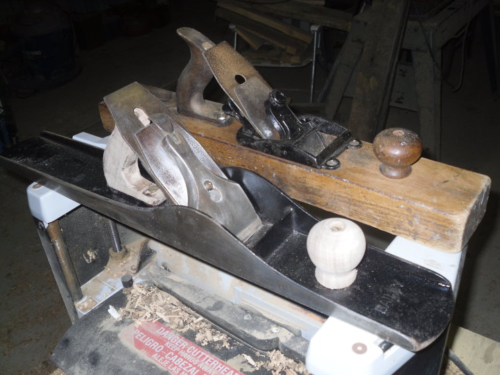

 Turned a knob, carved a handle for Mister bailey.  Then took him for a test drive on some Black Walnut:ning-handleproject001-33320-83.jpg?widthThe test drive resultsning-handleproject003-33320-27.jpg?widtha new knob and ning-handleproject006-33320-34.jpg?widtha new tote.    Still need to finish them up, then Mister Bailey will be ready to join his Elder brother #129ning-handleproject012-33320-7.jpg?width= A Fore plane, and a Jointer planer, sitting on a Planer.Grin.gif
Put a coat of stain/varnish on the handles last night:ning-handlefinish005-33319-44.jpg?width=One more clear coat, and a good buffing, and Mister bailey is ready for work.ning-handlefinish001-33319-36.jpg?width=Black Walnut for the handles, Minwax Dark Walnut stain, and a littlGrin.gife poly mixed in...

Wow that mouth is in real bad shape i don't think it is salvageable
steven newman said:
  Metal must have been real thin around the mouth opening:ning-bigmouth001-33318-81.jpg?width=721That is both the iron and the frog showing through.   This is the way I bought the plane.    The adjustor knob is solid Brass as wellning-bigmouth004-33318-43.jpg?width=721One more look at the blade group, all nice and cleaned upning-bigmouth003-33318-75.jpg?width=721We are getting there.   Blade is now almost sharp, getting a sandpaper treatment later.  Thanks for looking in.
PS: for those in West Central Ohio ( and you Hoosiers) this store just opened a few weeks ago, in downtown Sidney, Ohio.   Nice write-up in the local newspaper, too.    They still have some nice old handtools for sale, as well.Grin.gif
  mister bailey works just fine.    The frog takes the place of the sole in that area , anyway.
