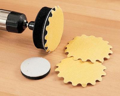

March 1, 201214 yr comment_33263 You are absolutely correct, Arlin, about skipping grits, especially when there is any end grain involved. Something that has helped speed up things for me is power sanding. I got this from Woodcraft- Bowl Sander http://www.woodcraft.com/Product/2003740/9297/3-Bowl-Sanding-Kit.aspx' target="_blank">This comes in either 2" or 3" variety to fit most of your needs. When hand sanding a project, while the lathe is on, the sanding scratches are almost across the grain, on at least, half of the time. Using the sanding pad, in a drill, while the lathe is spinning is sort of like a random orbital sanding motion. The sanding scratches are somewhat on the oblique to the grain. By working up through the grits, using this method, the scratches disappear much faster. Arlin Eastman said: Charles It is a Box not a Bowl to answer your other question, all scratches should come out. Either you are sanding to heavy and not using all the grits of sandpaper available to you. If you start out with 80g, you should go to 120g, 180g, 220, 280g or 320g, 400g and to 600g if you want a really nice feel. You can not skip grits because the finer grit removes the sanding marks for the lower grit.  Arlin Report
March 2, 201214 yr comment_33262 Lewis, I have that same sander - the grex and it works great. Â I also got it from Woodcraft. Â I was never able to achieve this kind of finish with a piece of sand paper in the same grits. Â Power sanding really takes the finish to a new level. Â SQLewis Kauffman said: You are absolutely correct, Arlin, about skipping grits, especially when there is any end grain involved. Something that has helped speed up things for me is power sanding. I got this from Woodcraft-Â Bowl Sander http://www.woodcraft.com/Product/2003740/9297/3-Bowl-Sanding-Kit.aspx' target="_blank">This comes in either 2" or 3" variety to fit most of your needs. When hand sanding a project, while the lathe is on, the sanding scratches are almost across the grain, on at least, half of the time. Using the sanding pad, in a drill, while the lathe is spinning is sort of like a random orbital sanding motion. The sanding scratches are somewhat on the oblique to the grain. By working up through the grits, using this method, the scratches disappear much faster. Arlin Eastman said: Lew Kauffman-Wood Turners Forum HostTime traveler. Purveyor of the world's finest custom rolling pins! Report
