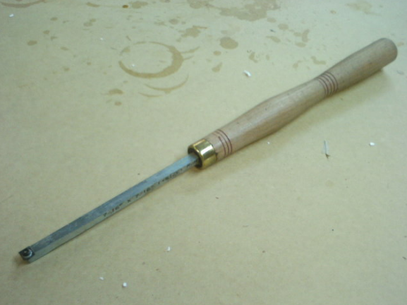

February 29, 201214 yr comment_33257 Lew I don't have the link on this computer but I will put it up tomorrow. I found a place where you can purchase the square cutting heads online. I think they are less than 5.00 each. You have to buy them in a pack of 10. Several of us went together and made several tools. You can get the square stock at Fastenal. Sorry this is not a great picture, but this is the one I made. Cost is about 20.00. John MoodySite AdministratorJohn Moody Woodworkshttp://www.johnmoodywoodworks.com Report

February 29, 201214 yr comment_33255 Here is the link to the Carbide Insert Knives. I was mistaken about the price I quoted last night in the post. The are 2.53/ea in a box of 10. They also carry the round one. It is listed on the right side of the pate under related products.I will also try to get a better picture of the cutter on the one I built.John MoodySite AdministratorJohn Moody Woodworkshttp://www.johnmoodywoodworks.com Report
