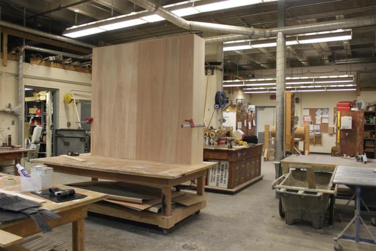

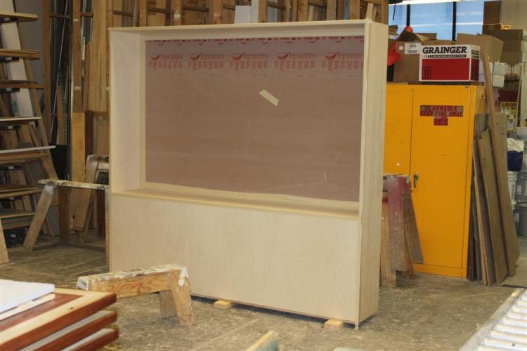

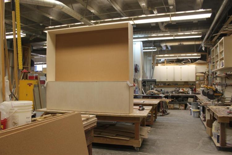

ning-displayfront-33115-12.jpg?width=750ning-display-33115-8.jpg?width=750This is what I'm working on at my day job for the Anchorage school district. It's a display case. It's maple  plywood and will have maple trim, cork back, glass shelves, and sliding glass doors.
It's 83'' tall, 91'' long and 16 deep. It will be set in to alcove in a wall.

Nice Rich!  Man that maintenance shop of yours reminds me of the carpenters shop I worked in for 8 years at Sea World of San Diego. I sure missed that place. Great looking case work Rich, how are you attaching the glass doors?
John, the glass doors will be by-pass sliders.  We have commercially  made track that unitizes a ball bearing raceway for the glass to roll on.  The face frame extend into the opening enough to hide the hardware.

Perrrrfect! What a cool cabinet, I love the bypass glass doors. The glass, 1/4" tempered I assume? How about pulls in the glass, glued in handles or molded indents for finger grabs?

Actually it's not has heavy as you think considering what you see in the pictures will be placed in the alcove as is. Then the face frame, hardware, glass doors, glass shelves and toe kick will be installed on site.  There's about 3 sheets of plywood as is.

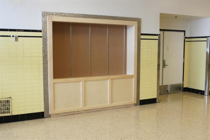

We got the display in place this week. We took the main case, face frame and toe kick to the job site as individual pieces.  laid the case in front of the alcove where I pocket sewed the face frame and toe kick to the case and slide it into the alcove. Worked out fine. Couldn't get it through  the door in one piece thus the 3 pieces. Still have a few details to finish up and then the glass people can come do their thing.  I'll post the finial photo when it's 100% completed.
As usual I found me another job with installing this one. Notice the return air grill on the bottom left of the picture is falling off the wall.
ning-displaycase-33120-88.jpg?width=721
That looks beautiful in there! The color of the maple goes really well with the existing colors.

Wow Richard, that turned out great. Perfect fit, but I would expect anything less from you.

Thanks John and Lew. The return cover will just be a matter of replacing the screws the kid have removed from the cover. Maybe some touch up work on the tile if the grill doesn't cover everything.
