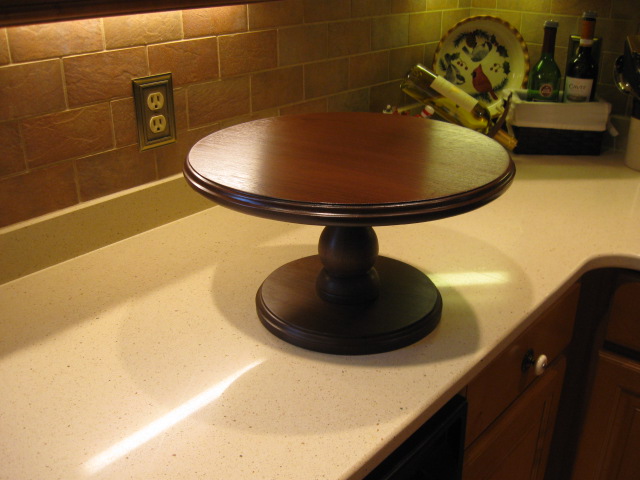

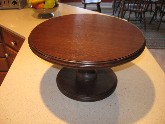

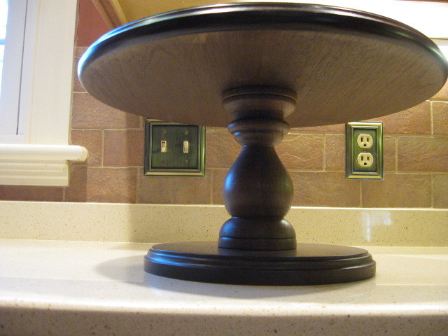

My middle son is getting married this month and after looking around for a stand for the wedding cake wanted to know if I could make one. Well you know me—couldn’t refuse the opportunity to make a new project so here it is. Made from Peruvian walnut the top is 16†in diameter with a 10†base and 9†tall turned pedestal. Used an Ogee bit for edge detail, sanded to 400 grit and finished with 4 coats of wipe -on poly. Fun little project.

To John--I get the Peruvian walnut from Wall Lumber In NC. Costs a little more than Black walnut ($7bf) but I love the consistency of the color  and grain and it works very much like mahogany.In case anyone is wondering, the base and top are attached with 1" tenons turned while I made the pedestal.
