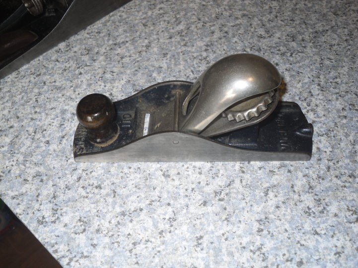

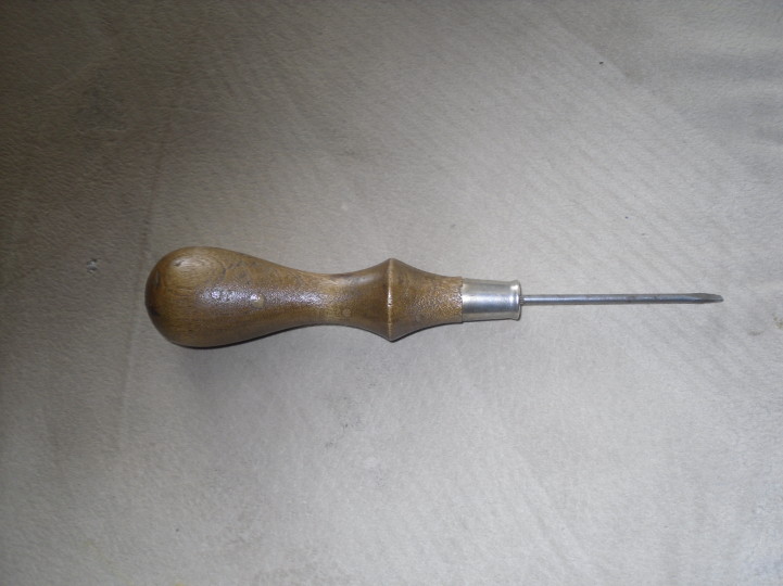

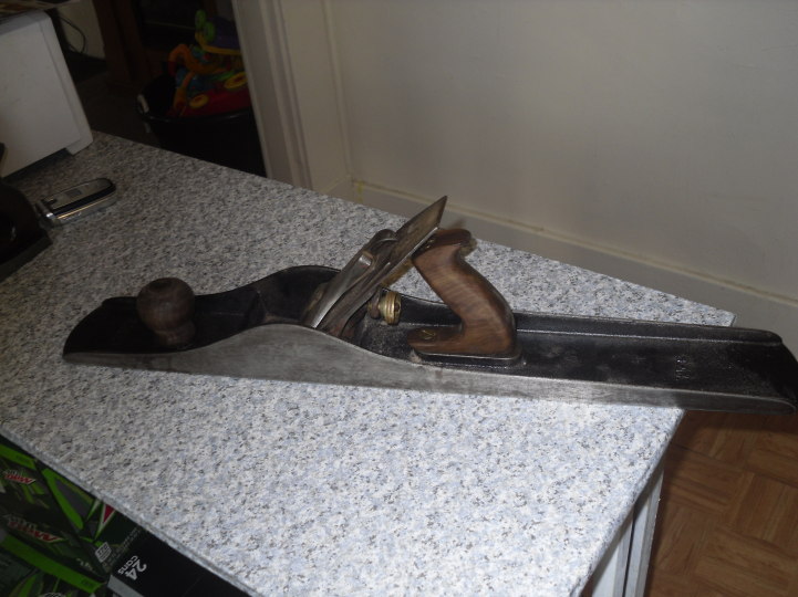

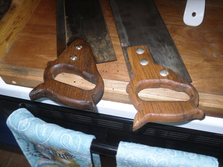

 Now, whatever gave you THAT idea?ning-handlefinish004-32921-49.jpg?width=Handsaws, maybe?ning-handlefinish005-32921-34.jpg?width= or a BIG handplane?Grin.gifning-handlefinish007-32921-21.jpg?width=Medium onesGrin.gifning-handlefinish008-32921-6.jpg?width=7Little ones? or even just rehandled screwdrivers?Grin.gifning-handlefinish009-32921-91.jpg?width=nah, ain't slippery, at all........24.gif

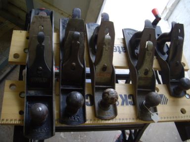

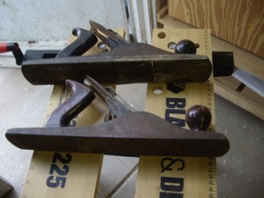

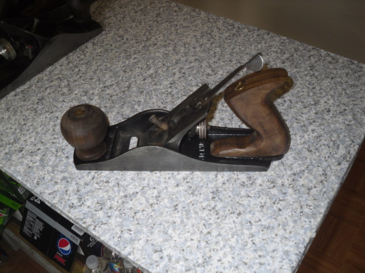

Here are some pix of my old plane stable. The #5 that I bought for $25 is the closest one in the picture.ning-011-32919-44.jpg

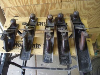

Here are pictures of the #4, the #5s, a #5 1/2 and a #6. ning-009-32919-69.jpg
The #6 is the only grooved sole. The 4 and 6 have patent dates of "March 05 02", "August 19 02" and "April 19 02" Couldn't find any dates on the others.
All but the one #5 were given to me. Not pictured is a #71 in the box. Also a gift.
One of these days, I'll get around to restoring them, if they are worth it.
Gene
