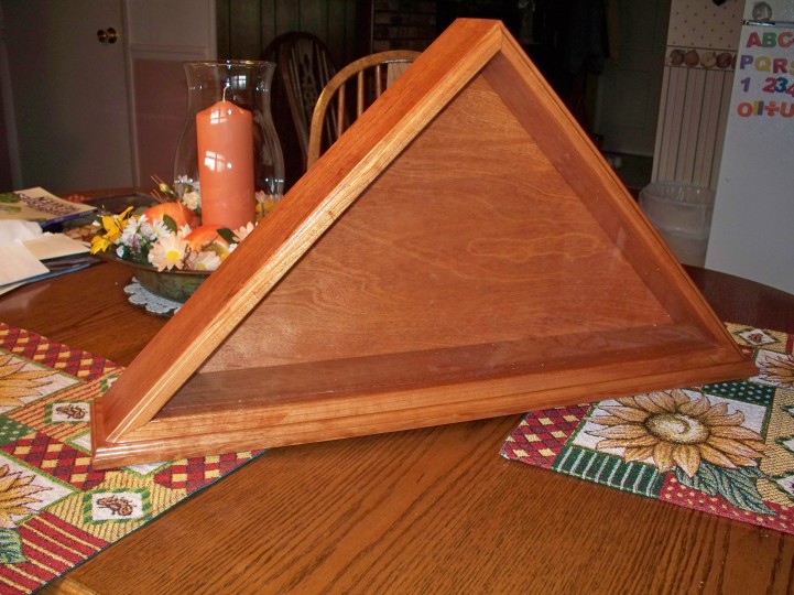

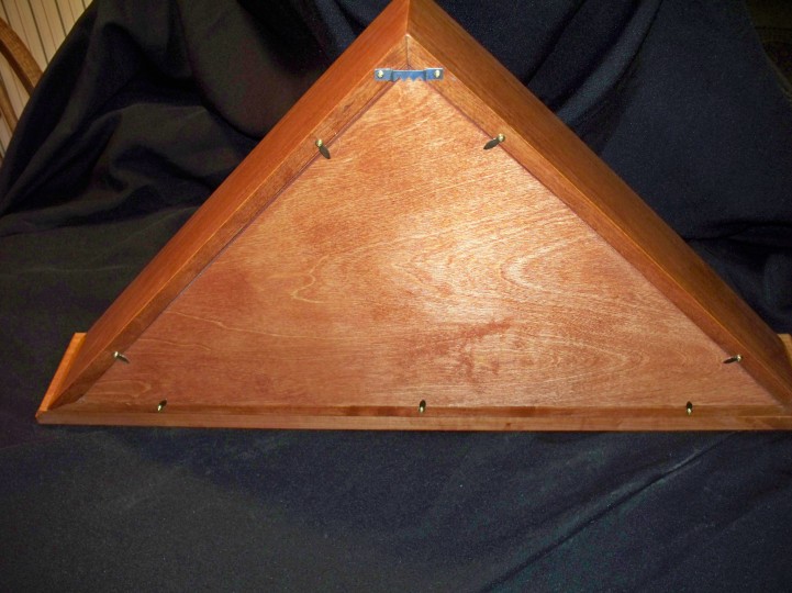

Paul, I make case and sell them regularly and I use an adaptation of the plan attached.  Instead of the two short feet I put a solid base on the case with countersunk screws and then I plug the holes and put felt pads on them.  As you can see by the picture I don't spline the ends and I use turn buttons on the back.  The measurements are very good on this design.  Hope this helps.  Looks like I'll have to send you the PDF but here's the pictures.

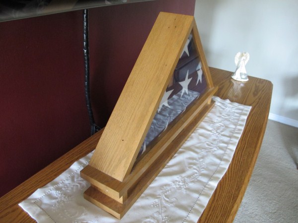

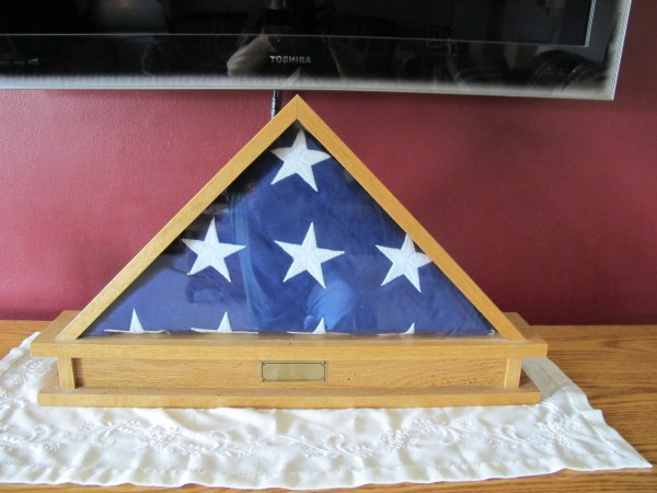

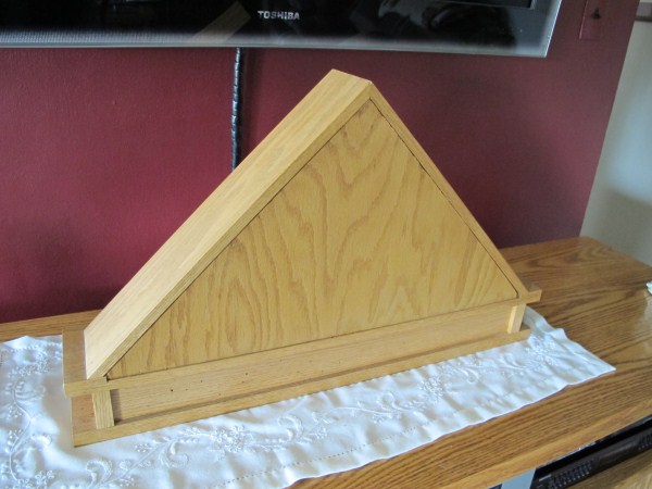

Here is an example of the type I've made. This one has a dado cut to hold the glass and the back is fastened with small brads. Later ones had a rabbet and molding to hold the glass to facilitate glass replacement. Also replaced the brads, on the back, with little "turn holders".ning-img-0866-32371-14.jpg
As you can see, it is nothing fancy but does the job.

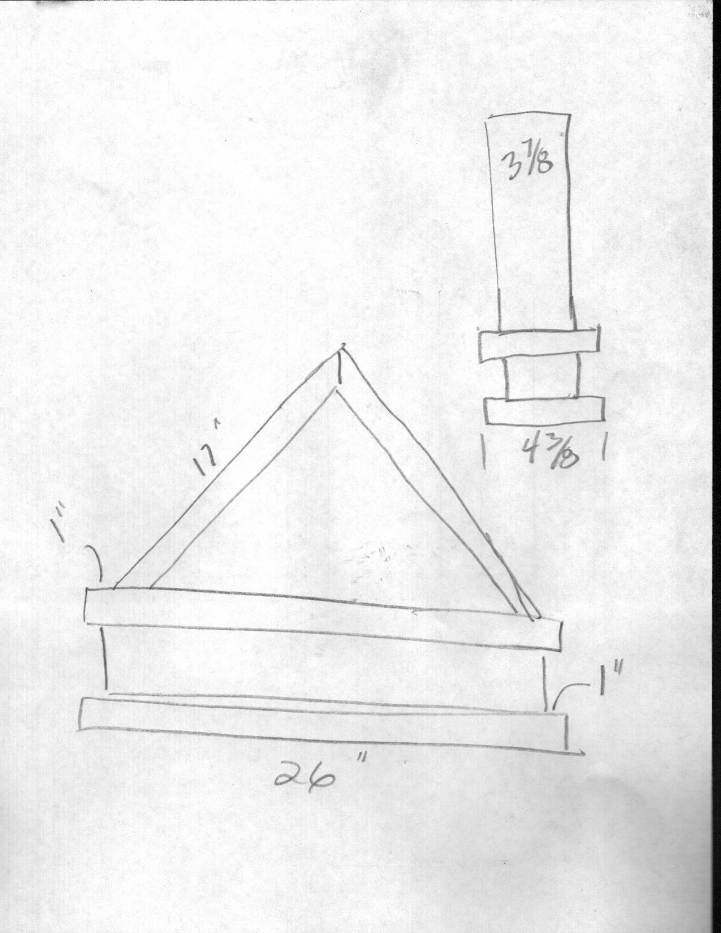

Here's a primitive sketch with basic dimensionsning-scan12-32368-76.jpg?width=721
